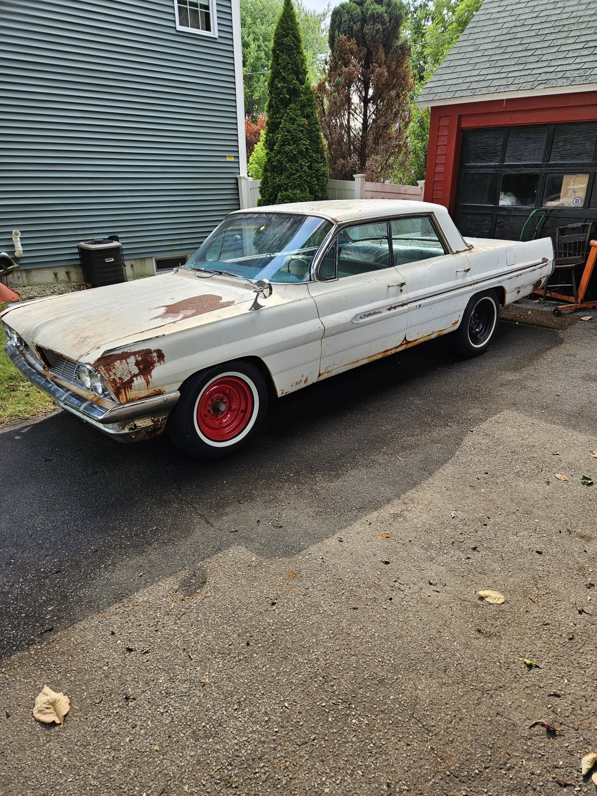

    Great progress on the Pontiac @Fourdoor64. I recently delved into the Pontiac 4dr world with a 61 Catalina.

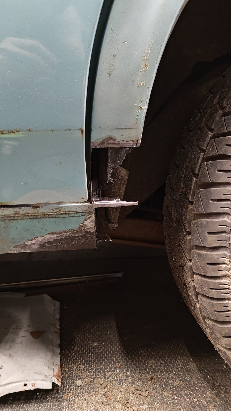

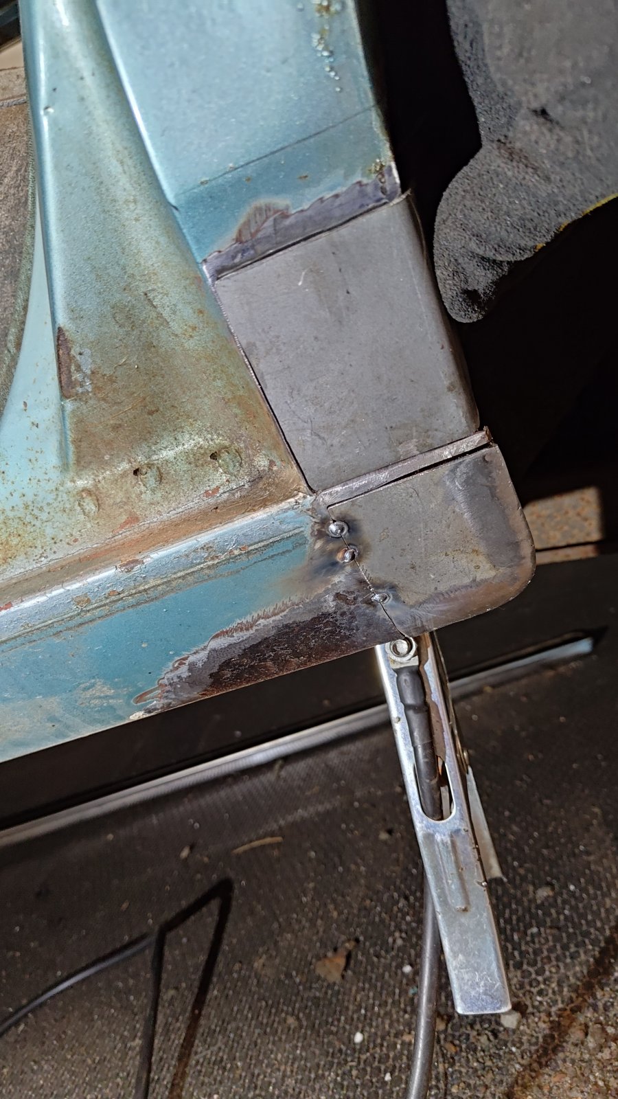

    Last night I took a break from the V8 car, and brought the six banger tempest in the garage to practice a bit of bodywork. The rust has been coming back in full force since my highschool bondo gl*** repairs back in 2018. I'm trying to spiff the car up for the Adirondack Nationals in Lake George a few weeks from now, so I figured it's as good a time as any to try something new. It's my first time ever making patches and using a welder for bodywork. It may not be perfect, or the right way to do it, but i feel better about doing this than filling it back up with mud. This car is banged up, rusty, been hit, and overall a driver - not a show car, so I don't mind practicing on it. Still a little work left to do on that patch, but overall I'm happy with it for my first one. Hopefully I have good luck with the other 6,345 patches it needs, I'll be saying my prayers.

    I've been doing welding/rust repairs for decades and I'd say your work there looks very good, and especially good for a first-time repair.
    The blistered area just above your new patches might end up being pinholes by the time you grind that out. Usually if you're making a repair panel, you can make it extra large and include pinholes and some surrounding area, because the back side of that is probably pitted and ready to break through fairly soon. But if you're trying to blend in the original paint in as small of areas as possible, the way you're doing it is probably as good as it gets.

    Hey thanks! It definately ended up coming out better than I had anticipated (thanks to my trusty grinder lol). I did want to include the upper part with the bubbling, but i was a bit intimidated by the body line in that spot. I may give it a go now that I'm feeling a bit more comfortable with it.

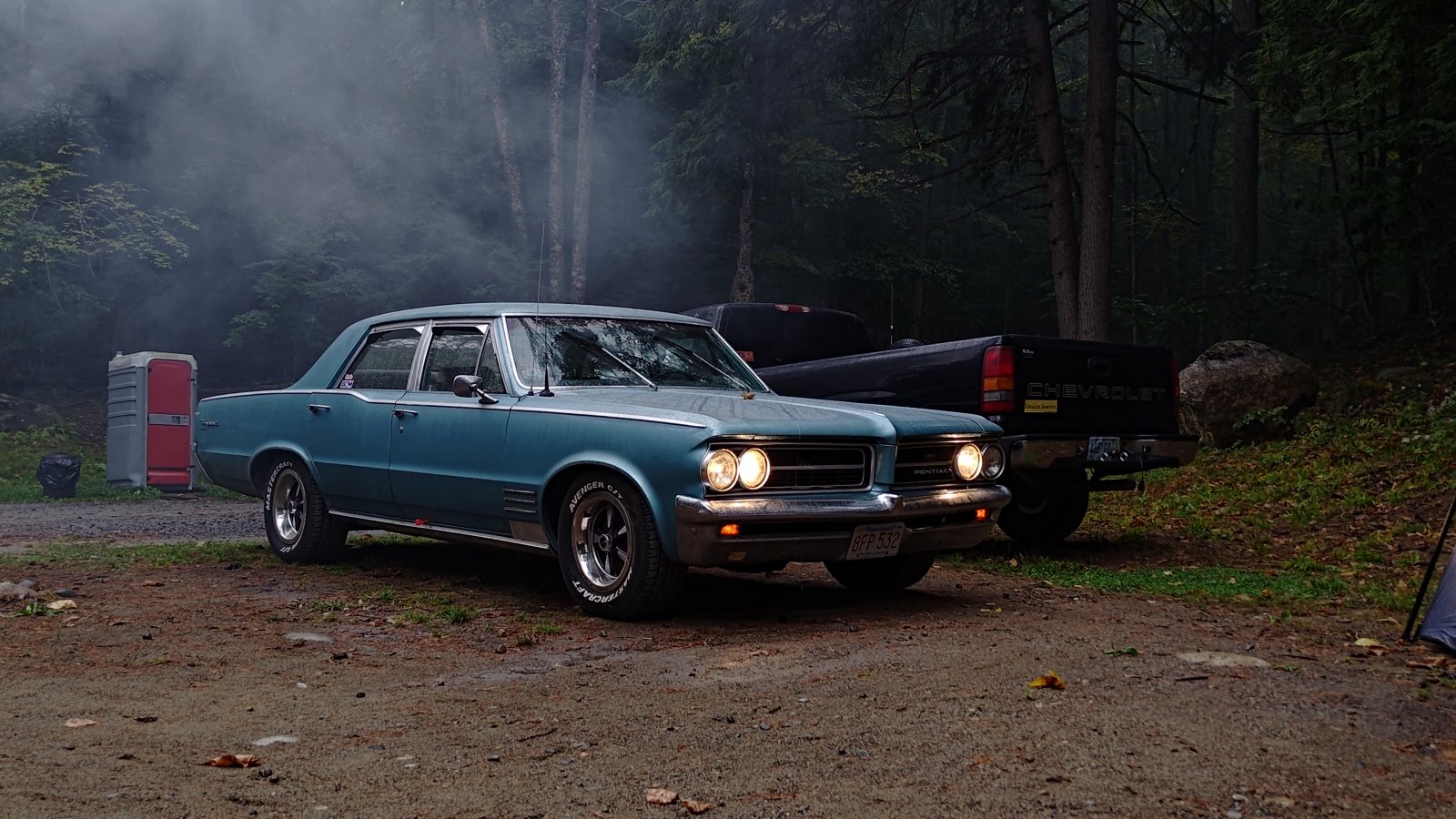

    Just got back from a camping trip to see the Adirondack Nationals show in Lake George NY. Had a blast with some friends and saw an unbelievable amount of really cool stuff. First time going but we all agreed it'll be a yearly trip from now on. The 6 banger tempest did great as always. No real issues other than a headlight going out. The thing is an absolute dog with the tired 215 mated to 2.56 gears, but it always gets me to and from wherever I'm going without any complaints. Next year I'd like to have a little more fun on the drive though, so back to the V8 one. I'll be working on it this week and hopefully I'll have it done enough to enjoy some fall cruises around new england.

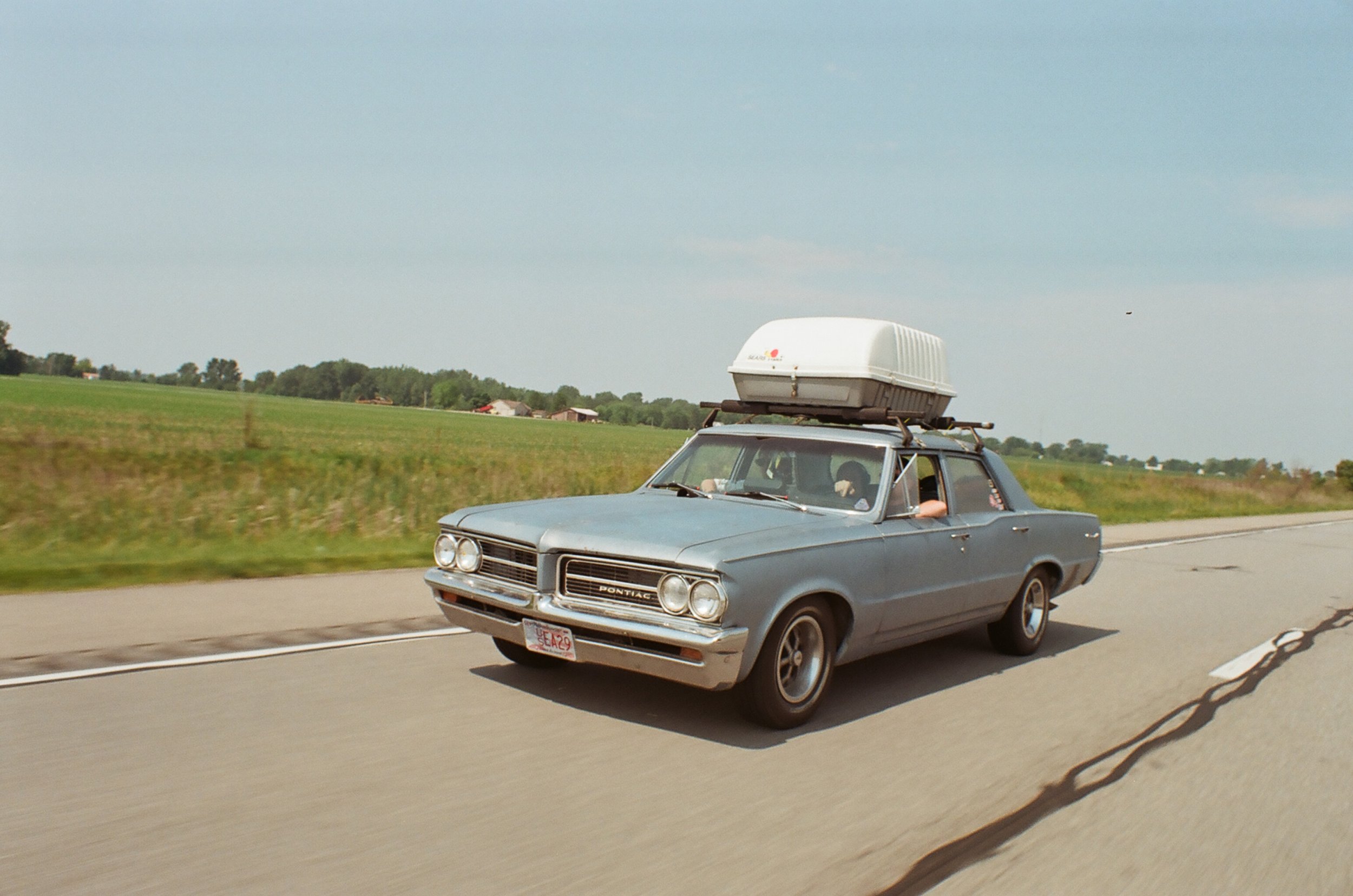

    Recently noticed I hadn't updated this in a while. The car did make the whole trip, from eastern M***achusetts, out to Michigan, and back, all in one piece. We had some issues - but once ironed out - the car did great. We even cannonballed home the last day from Ohio to M***, 12 hours, only stopping for gas. Good machine.
    treb11, Squablow, bobss396 and 2 others like this.

  20. Squablow
    Joined: Apr 26, 2005
    Posts: 18,544
    Squablow
    Hadn't noticed the update, love the pics with the S-Cargo on the roof! Who needs a wagon when you've got that?
