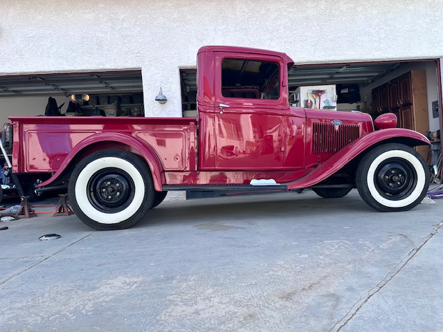

    here's what I'm working on...I've always thought the front tires were too big....and the big white walls give too much preppy /collage boy look for me... I like the more hotrod outlaw look... IMG_4554.jpg

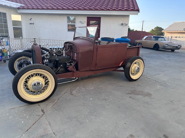

    also I thought the set would look better on my 34 ford... so I swapped... IMG_5435.jpg

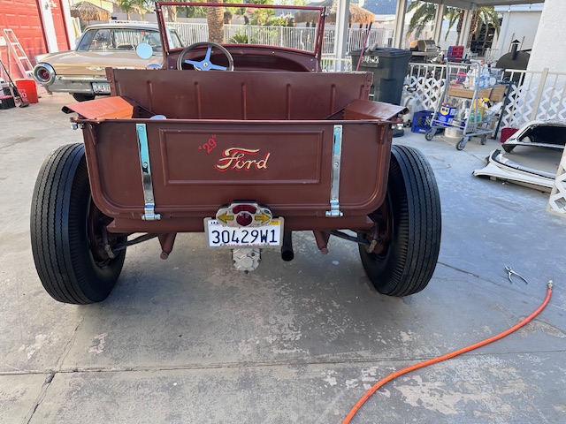

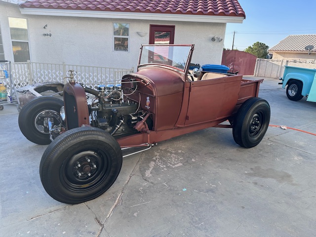

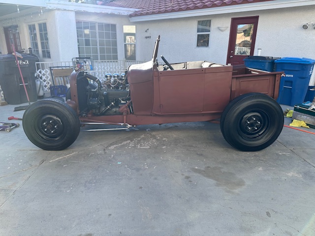

    IMG_5452.jpg IMG_5453.jpg IMG_5454.jpg the 29 got the short end of the deal...total wrong IMO....I don't know if theres a name for this look...I'll just call it wrong....

    so got her done...still haven't decided on caps... hope the pics are ok... the tires are date code 1024
    IMG_5468.jpg IMG_5469.jpg IMG_5470.jpg IMG_5471.jpg IMG_5472.jpg IMG_5474.jpg

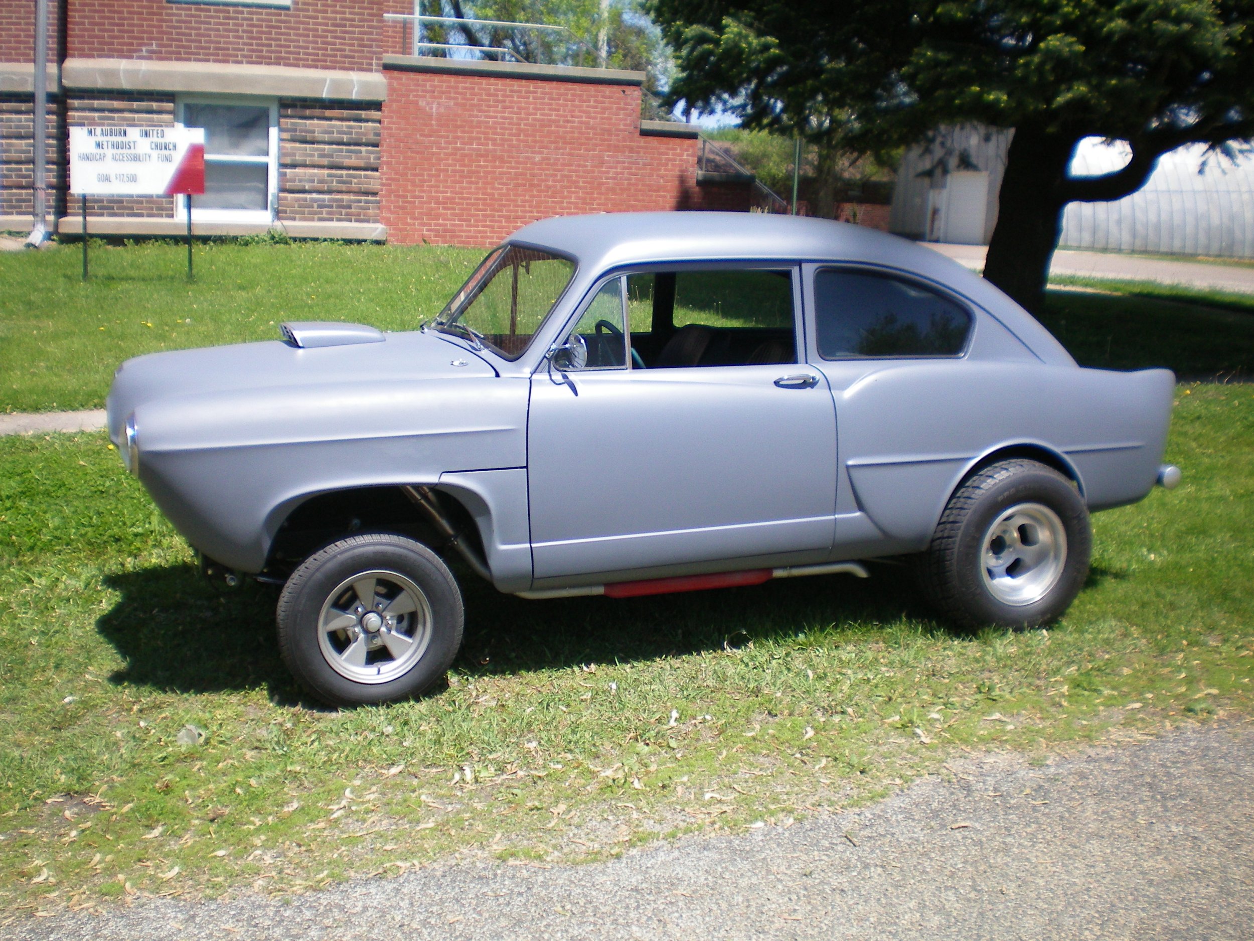

    These Sears Raders on the front didn't have safety bead bumps. Worked fine for the short time I ran them. I don't remember if I used sealer on the rivets.
    Gary
    ALLDONE and pecker head like this.
