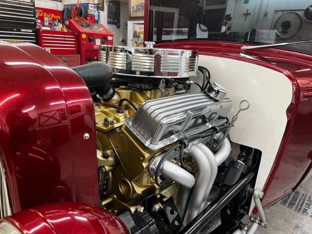

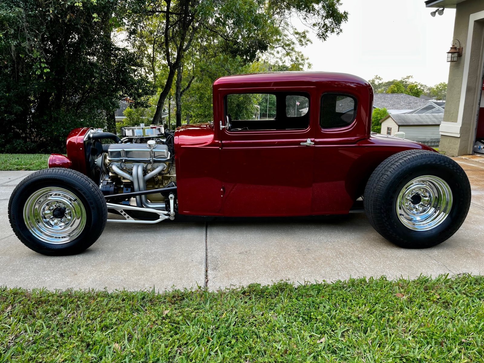

  18. AHotRod
    Joined: Jul 27, 2001
    Posts: 12,318
    AHotRod
    Q-Jet's RULE
    I have one on my Coupe's engine.
