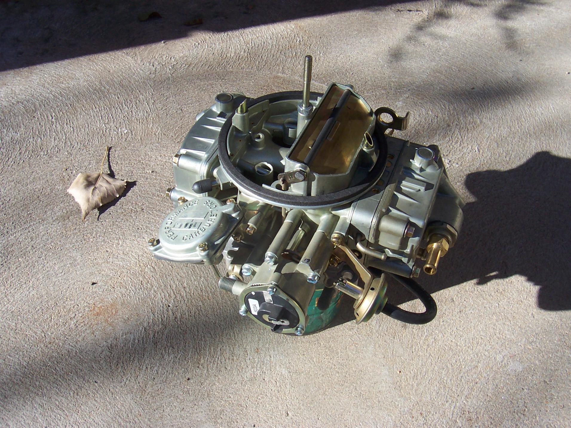

    I've got a Holley Quadrajet replacement carb (spread bore w/large secondaries) that I bought new and ran only one summer before I did an engine swap to a FI motor and didn't need it any more. The carb has less than 500 miles on it and ran like a charm. It cost $375 at Summit Racing new. It's yours for $250 plus shipping if you want to go this route. PM me, email me at cbillelder@comcast.net, or call me at 970-330-6958
    Bill
      497.2 KB
      118
