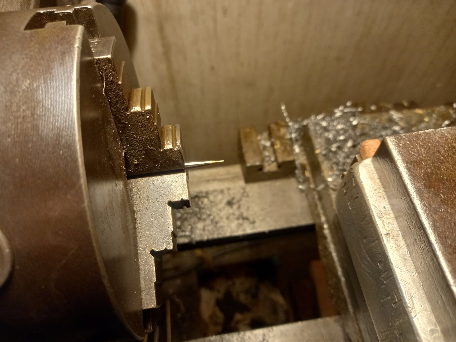

    Needed some smaller metering rods...
    Dont want to wait for parts...here in germany you can't buy them easy everywere...

    Can't knock it if it works.

    You have to be really carefull, but as I also worked as a clockmaker cant really say that this things are small ....

    Try to polish up the surface with some fine emory cloth as best you can. You don't need the rods getting hung up when they drop down in the jets.

    I polished it with some worn out 400 grid paper and a drop of oil, the picture was taken before.

    Good on you Zottel ... secondary rods make a huge difference in performance on my Q-jets.
    So far I've been able to come up with combinations that work from my stash of parts.

  9. That's exactly what I did 60 years ago when Qjets parts were not yet hanging from every other tree.
    Actually, I took the original stock rods over to my dad's shop where he was a tool-and-die/investment casting mold maker, during his lunch break. Those were simpler times when I could just walk in the side door into the shop area and everybody knew me. (I had previously worked there myself as a machinist.) I could have cut down the metering rods myself but I trusted my dad's skills more than mine. So I explained what and how the rods worked and why the taper. That just took a minute and another couple of minutes on the lathe and it was a done deal.
