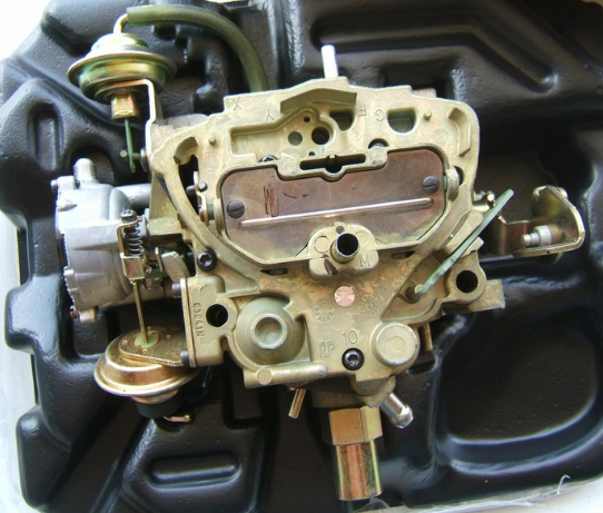

    I was shuffling some parts around in my shop yesterday. One of the items I came across was a Rochester Quadrajet carburetor. While looking at it, I was impressed at how small the primaries are. I have had Quadrajets on a couple of cars and always liked them. There was a Sharp 4 BBL manifold for an 8BA hanging on the wall over my bench that started me thinking. I knew I had a Quadrajet to Holley adapter, so I dug it out and started piling parts on parts. To make a long story short, it looks like I can mount a Quadrajet on that manifold using the adapter by drilling 4 holes and buying 4 allen-head cap screws. After my experience with 2G's on Merc manifolds, I think this is something I might want to try. It looks like the primaries are small enough so they won't overwhelm the engine (my 258" with a MAX-1 etc.), but I wonder about those huge secondaries. Will the engine sort of self-regulate, or will the secondaries flood it out? Any thoughts and suggestions will be appreciated.

    The secondary air valve is tunable to a certain extent. If the engine bogs when the secondaries open, you can tighten the spring. It is sensitive and can be very finicky to get right.
    There are also multiple sizes of Quadrajets. One for a 305 Chevy would be a better starting point than one from a 500 Cad or 455 Olds. I think there were even a few made for the Buick V6 but I'm not sure.

    Most Qjets are the same size. The secondary air valve has a spring that you can adjust to control the opening. There is usually also a vacuum diaphragm that works to close it, too.
    It's a demand secondary system, so it adjusts itself to the required airflow.
    A carb that is too large does not "flood out"....rather, it will "lean out" because there is not enough air velocity to create enough pressure differential to get the fuel to flow. The Qjet when set up right (to factory specs, in most cases) does not have this problem, because the primaries are so small, and the secondary side has that air valve to limit airflow to what is needed.

    Ur better off running a small base Carter or Rochester from the early 50's on a flathead. They bolt right on the 4 barrel manifolds with no adapters, have small primaries, and don't look out of place. If you've still use the original ignition that's all vacuum a Holley 4000 off a y-block will work without doing anything.

    I've been looking around, and it seems they made Quadrajets for 262 ci Chevrolets; that seems about right for my 258" engine. Also, from what I've found, you can make just about any Quadrajet run on any size engine.
    As to looking funny, yeah, I know. The reason I got thinking this way is that I have a rebuilt Rochester 4GC from a '53 Olds I was going to use on the Sharp manifold. I just came across another '53 Olds 4GC, which I bought because I have an Offenhauser dual quad manifold for my '51 Olds. Matched early 4 BBL's are really hard to find and extremely expensive when you do. It looks like the 4GC's are going on the Rocket, so I have to find something to run on the Sharp. Have you guys priced WCFB and 4GC cores lately? If you can find them? This Quadrajet thing is looking better all the time.:)
    "jimmy six" - your point is well taken, but I love to fool around with things and I'm cheap; probably a bad combination. I haven't seen a reasonably priced usable WCFB or 4GC core for literally years. Now Q-jets on the other hand, are a completely different story.

    I wonder if you might want to consider a Rochester DualJet, which is essentially just the front half of a Qjet. Maybe from a '79 or '80 Caprice, Malibu or Monte Carlo with a 267" V8. Pre-'81 federal emissions models will get you away from the electronic fuel mixture controls. I think there was also a DualJet that looked like a full size Qjet but the secondary throttle bores were cast shut.

    Up to and including 1974, Q-Jets came in 3 sizes: 750, 800, and 850.
    The Q-Jet has a "demand" secondary; thus the 3 sizes may be looked at as:
    750 = 150/600
    800 = 200/600
    850 = 250/600
    The first number is the CFM of the primary side. The 600 is an "up to" figure, depending on the needs of the engine.
    Unless building one for a numbers-matching show car, the 1965, 1966, and 1967 versions are best left to those that ARE building number-matching show cars.
    The need for primary throttle shaft bushing is well-known, as is the stripped fuel inlet threads (especially on the earlier models with the 3-thread inlet fitting).
    The very best money to be spent on a Q-Jet (if you have not done so already) is to purchase Cliff Ruggles' book "How to Rebuild and Modify Rochester Quadrajet Carburetors".
    Best aftermarket carburetor book I have read since I started doing carbs in 1959.
    The problem I see (and it may not be a problem, I don't know) is the lack of availability of an intake manifold for the flathead with a Q-Jet footprint. AIR/FUEL MIXTURES DO NOT LIKE ADAPTERS!!!!!!! - Think NASCAR restrictor plates, which are more effective than a spread-bore to square-bore adapter!
    Often, placing a larger carburetor on the wrong manifold through an adapter LOWERS the effective air/fuel flow. The adapters are basically good for the used car salesmen, and the posers that have cars that are "parking lot fast".
    And to "parrot" what others have said in this thread, the Q-Jet is an excellent carburetor; but some are better than others.

    I just ran the number on the carb I have. It is a 7040200 and looks like its from 1970 Chevrolet with a 396, 400, or 454 engine. It's probably not the best place to start for me on this project. Or is it? Does anybody know what I need to do to tone down the secondaries or where to find that information? Maybe it's a rare carb off an LS6 Corvette and I can sell it on eBay for lots of money to one of those "gold-chainers":D. Seeing it's a big block carb, it's probably one of the 850's. I think I'll start haunting eBay looking for something a little more suitable. (I also have the original carb from my '68 Corvette 300 HP 327 that I could rebuild and use temporarily.)

    Tubman - as Jim suggested, the Qjets for the larger Chevrolet engines were nothing special; yours is a 750, and relatively common. One from a 327 or 350 Chevy would also be common (cheap) and a better starting point.
    Bruce - Pontiac used the Qjet on the Sprint Option from 1966 (230 CID) through 1969 (250 CID). However, these bring collector prices so not a great starting point for a non-collector.
