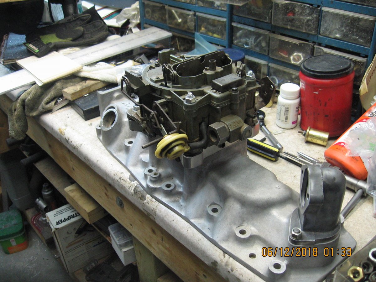

    Because the throttle lever and fuel inlet line up better that way. I found this out when running 2G's on bored out Merc manifolds. They seem to run fine that way. I don't see why this would be any different.

    The Rochester 2G series have the float suspended from the airhorn, whereas the Q-Jet float is in the bowl. This changes the geometry of buoyancy that may be effected by rapid acceleration (if this is desired) with the carburetor reversed.
    The 7040200 does have the revised (better) float placement.
    Suggestions:
    (A) Use the 0.125 fuel inlet valve (don't use the 0.135, and don't even think about the 0.149)
    (B) Make sure it is the non-windowed design
    If you run rich under acceleration, this might be a good place to look for the cause.
    Jon.

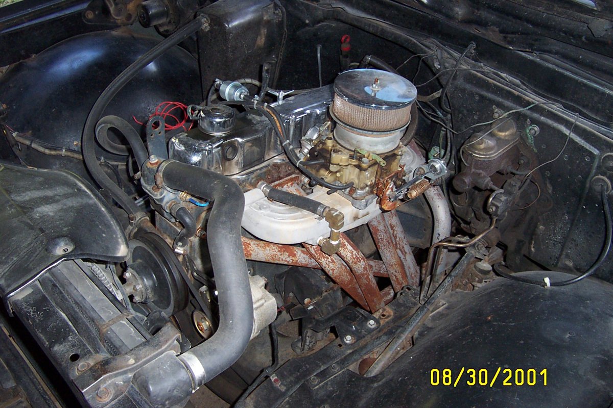

    Yeah, me too. I ran a small Q-jet [IIRC it was spec'd for a 262 Monza] on my 68 chevy pickup with a 292 six banger and it ran great! Loved it. 68chevypu.jpg
