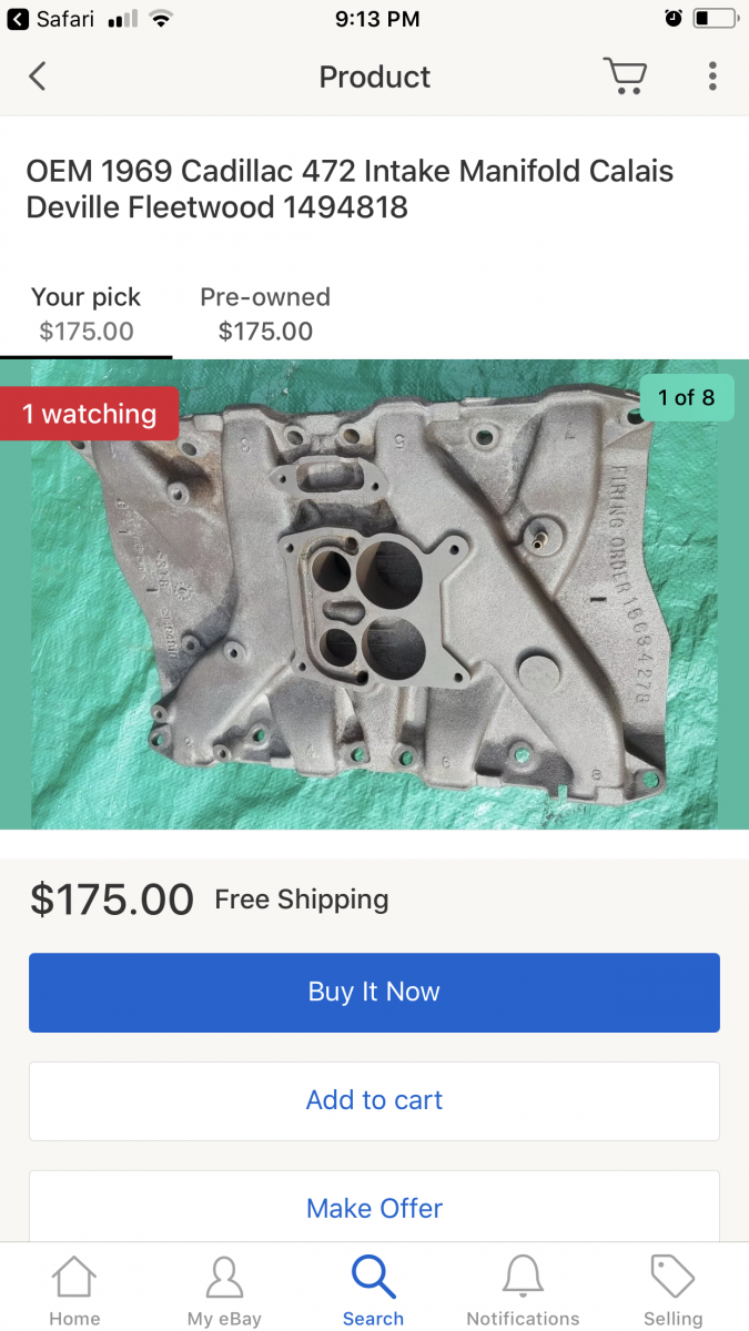

    hey guys, I have a 68 Cadillac 472 and the carb is shot ( corroded beyond repair ) I’m trying to find the correct carb but the intake manifold of the 472 has some kind of exhaust passage near the front of the carb mounting area that they don’t all have. I don’t think just any rochester 4 barrel will bolt up. Don’t want to make a pricey mistake! Anyone know about these caddy parts?

    You are missing the stainless steel heat plate like these listed,231382551915 .

    Thanks for the reply, so does that plate go direct to the manifold and block the passage? The gasket I took off is the same shape as the manifold. Or does the gasket go first, then the metal plate then carb and I could use just about any Rochester 4 barrel?

    I inserted small freeze plugs in manifold to keep exhaust heat away from carb. Then Felpro carb heat shield #60731. Also used a quarter inch phenolic spacer. Carb gasket is Felpro #60043.

    I've run into those on some Chevys. I usually tap them and screw in a plug. Then drill and tap from the outside, and install a small set screw, which keeps the plug from moving.

    I think I used gaskets on both sides of plate. Hope that helps.

    I plugged that exhaust passage on my 429 Cad and added a spacer as well to reduce the heat to the carb. Runs great with no problem in cold weather. Admittedly it is not a regular driver car.
