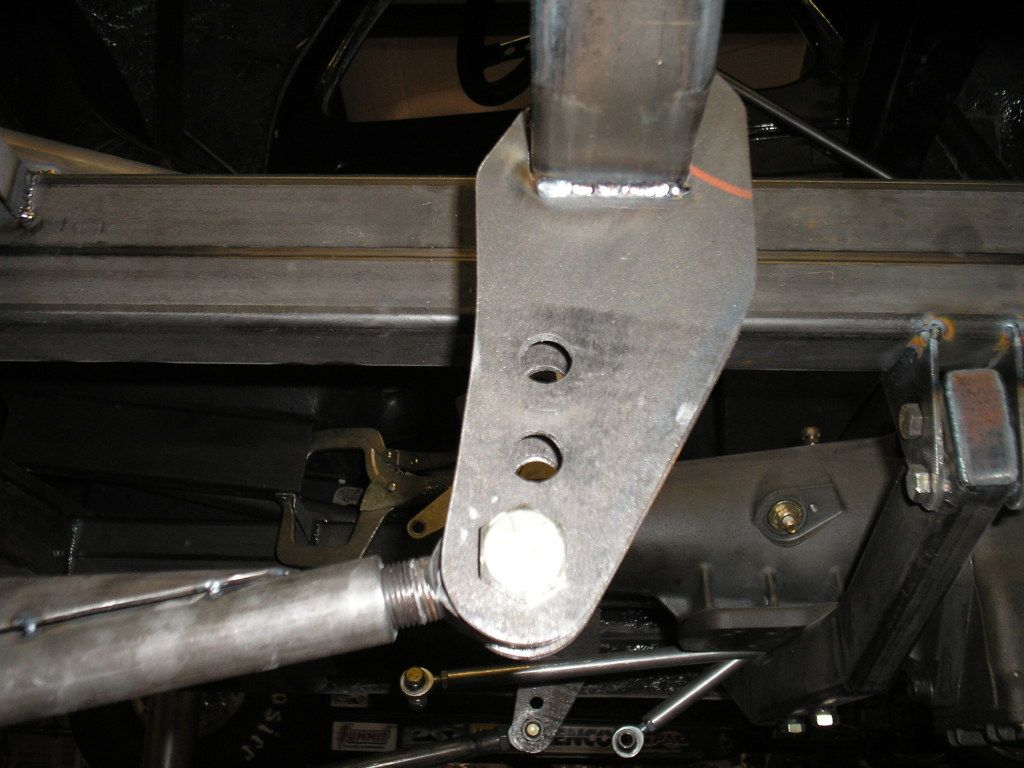

    Hi Quain,
    Any chance you can elaborate on this ? C/G makes sense sort of, but how does the height play into this?

    This is hard for me to explain with out drawing a pic and I don't know how to do that on here, but I'll try to explain it in my red neck way. You will have to imagine a big box setting on the floor and you walked up to the box and punched it hard in the dead center. That would be the exact C/G, the box would slide straight forward with no rocking motion. Now punch the box at the top, the box would rock over forward that's above C/G. Now kick it at the bottom the box will rock back towards you at the top that's bellow C/G. The mounting point of the ladder bar is what pushes the car if it has floaters or coil springs witch most all do now days. The front mounting point of the ladder bar is punching the box. So if you had it at the exact C/G height the first move the car would make would be straight forward with no weight transfer. If it was above the C/G the nose would fall and there would be negative weight transfer. Now put the mounting point as close to the ground as possible way below the C/G and you will have front end lift to the point it would brake the wheelie bars. So what I try to do is find a sweet spot to where the car just touches the wheelie bar very softly so not to unload the rear tires. There is math for this but most don't know when doing a new build where the C/G height is going to be. That's why 4 links ( a big no no for a G***er) became so popular in the early 70s. With a 4 link the push point is where an imaginary line is drawn through both bars until they intersect, (same as the front mounting point of a ladder bar) the intersect point is where it pushes from. Now you can just move the top or bottom bar up or down (with out changing the pinion angle) to get the sweet spot. If you looked at the intersect point on my pro mod car it is only about 6" off the ground. Look at the intersect on my G***er and it's around 10" off the ground. That's because the C/G is way higher on the G***er. in other words the box is taller. Another big factor is where the C/G is front to back. you start getting into correct length bars but we won't get into that today. Hope this helps.

    Amazing build, and thanks for the C/G height explanation! Great ****ogy!

    Guess I'm a red neck because it makes perfect sense to me now. Thanks a lot!

    You can find the more scientific explanations in ch***is books but it's telling you the same thing in the end, my red neck version is just less confusing.
