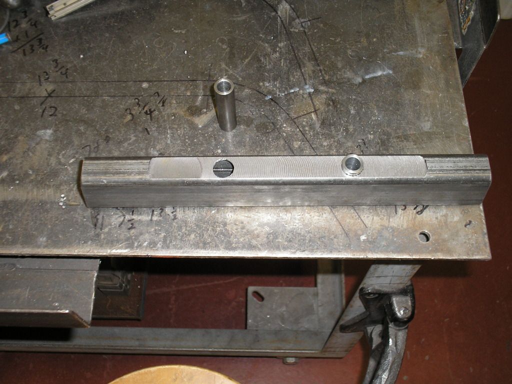

    Quain Stott
    Now for the trans cross member 1x2 with .083 wall building I built it strong because it's going to also act as a ch***is cross member. I milled a flat spot on the tubing so it will set right on the trans mounting flange. The bushing have a 7/16 hole for the trans bolt.[​IMG]

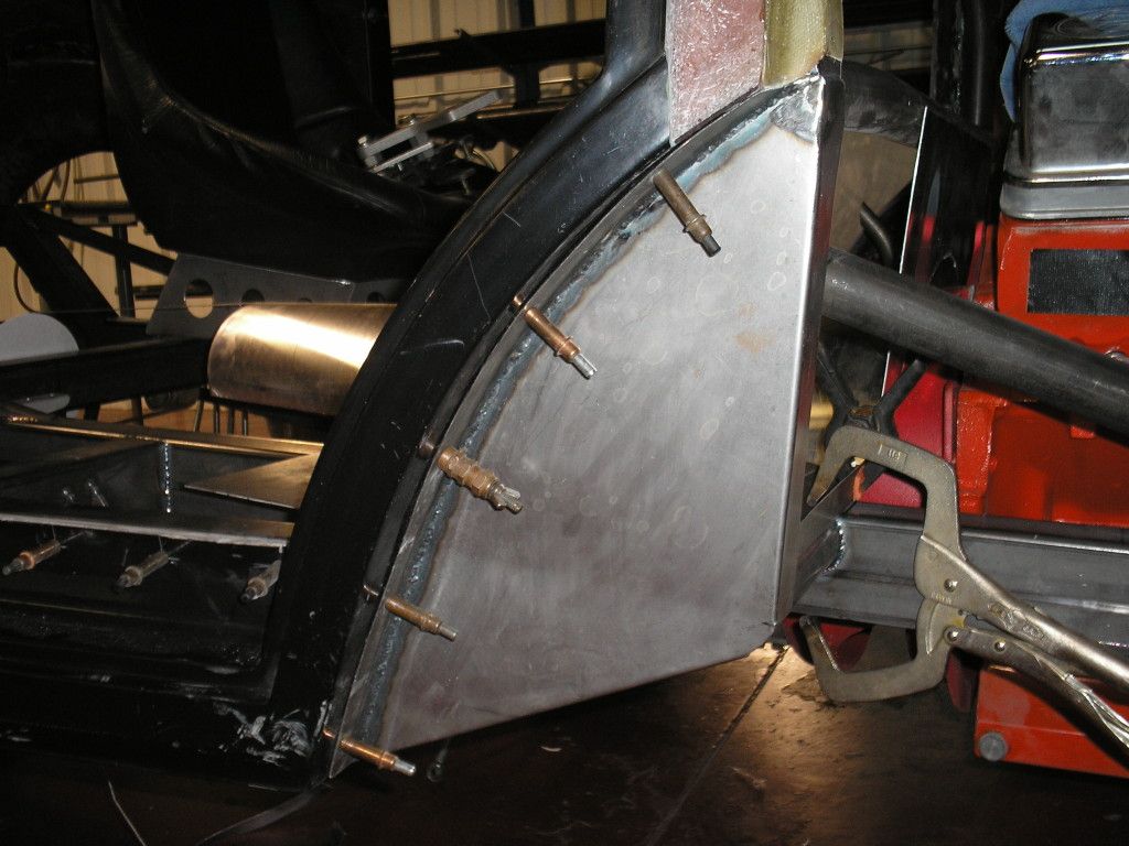

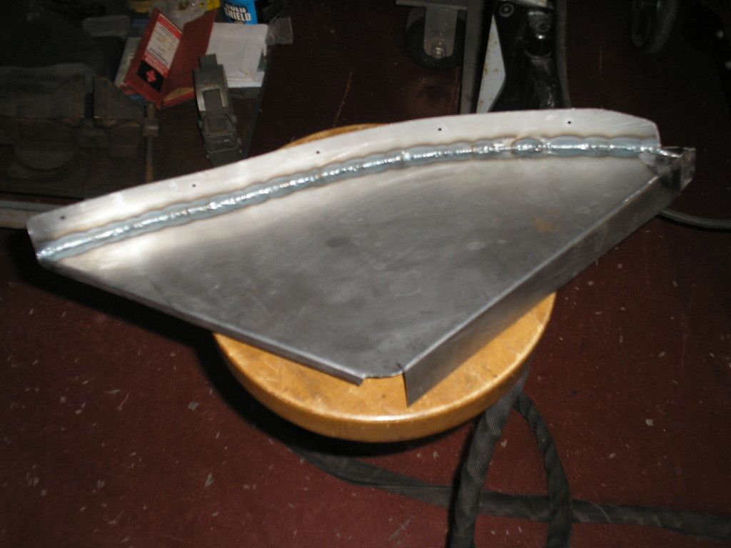

    Quain Stott
    This will be a body mount as well as a filler panel for the area down at the front bottom of the door.[​IMG]
  22. Quain Stott
    Joined: Nov 21, 2006
    Posts: 2,068
    Quain Stott
    Installed filler panel. In this pic you can also see a small part of the gl*** work that I had to do around the fire wall area. It had a stock fire wall when I cut it out I had to build a lip back for the fire wall to bolt to. Note I said bolt I don't use rivets unless there is no other way.[​IMG]

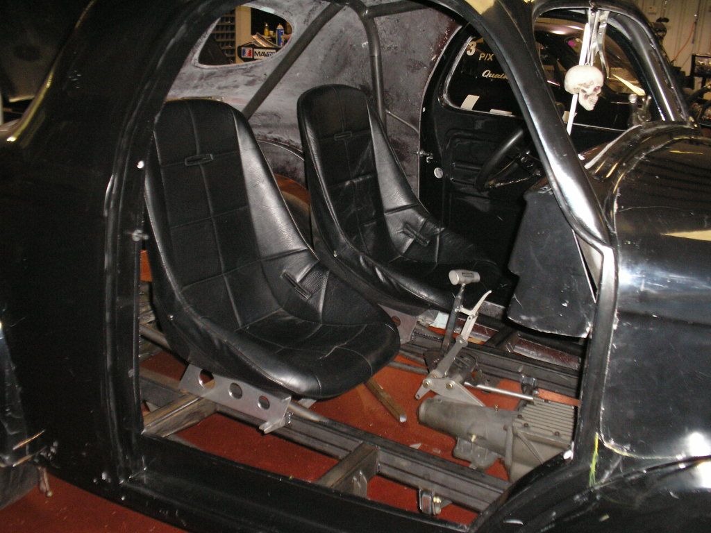

    Quain Stott
    The other side. You can also see the seat mounts I just bent sone .090 4130 plate nothing trick. The bar you see is tied in to the highest point of the frame rail and goes under the seat. It's not period correct but it's hid in the end.[​IMG]

    Quain Stott
    Finished seat mounts. You can also see that I had to make me a shifter stick to get rid of that star wars looking thing that was in here in the pics that was posted earlier.[​IMG]

    Quain Stott
    With both seats and that man stick sticking up between them. Ya'll don't have any idea how much trouble I had finding low back seats. High backs just don't look right in an old school g***er.[​IMG]
