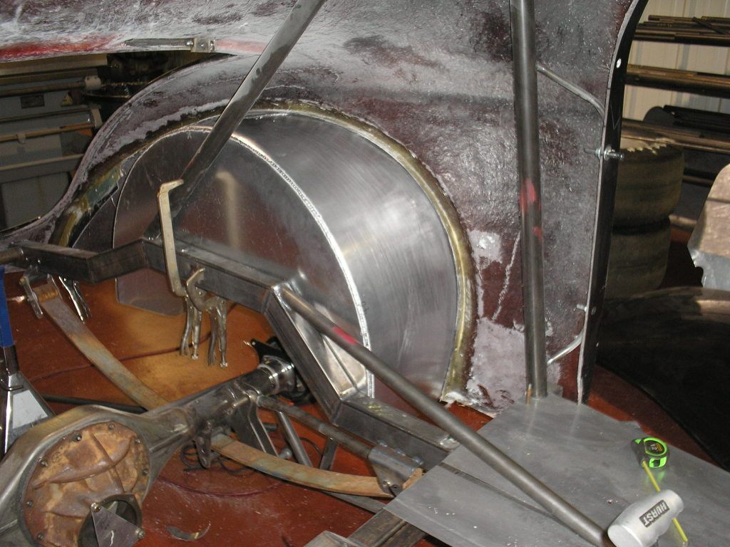

    I didn't know if racers in the 60s was using the Pittsburgh joint like we did in the late 70s or not to join there wheel wells together and I couldn't find any pix's of anybody's to find out so I just welded mine together. [​IMG]

    Another angle, in this shot you can see the lip I had to make to bolt the wheel well's and rear fender too. The ratty gl*** work you can see behind the wheel well will be trimmed up later. [​IMG]

    The drive shaft cover and center panels this was a lot of work I was not in the mood to take pix's while I was doing it for some reason but here's one with it ruffed in. The drive shaft cover will also be removable. [​IMG]

    The panel to separate the driver from the trunk was tuff to make but not near as bad as the lip that you can see that I had to make with fibergl*** to bolt it too around the top and down the sides. It would have been a lot easier to do an a metal body I could have just welded it. [​IMG]
