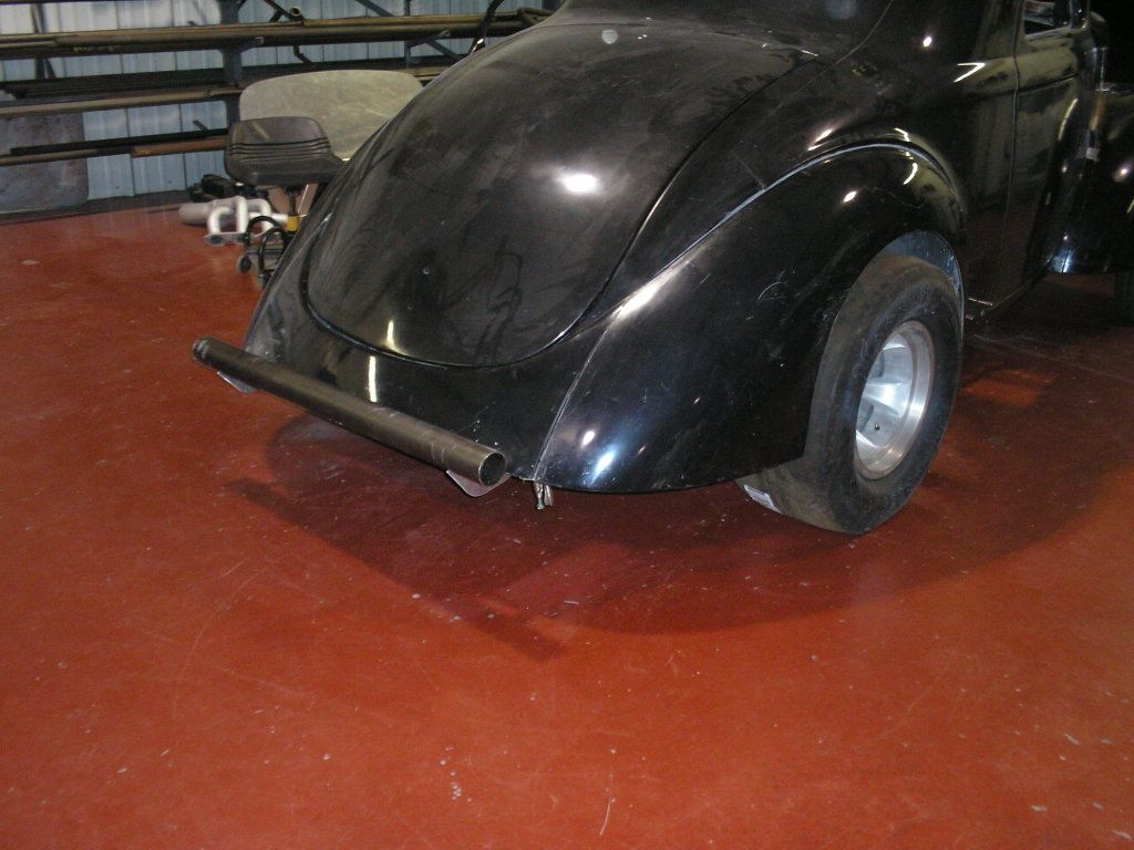

    This is the start of the bumper mounts [​IMG]

    I just took and old drive shaft that I had laying around and cut the tubing out of it that I needed. If you remember the bushings that was welded in the rear part of the frame rails on page one of this build thread that's where the alum. bumper brackets bolt to the frame a weight bar will also go there if needed. Never mind the non era correct rear wheels, they were advertised as halibrands copies but they are not even close.[​IMG]

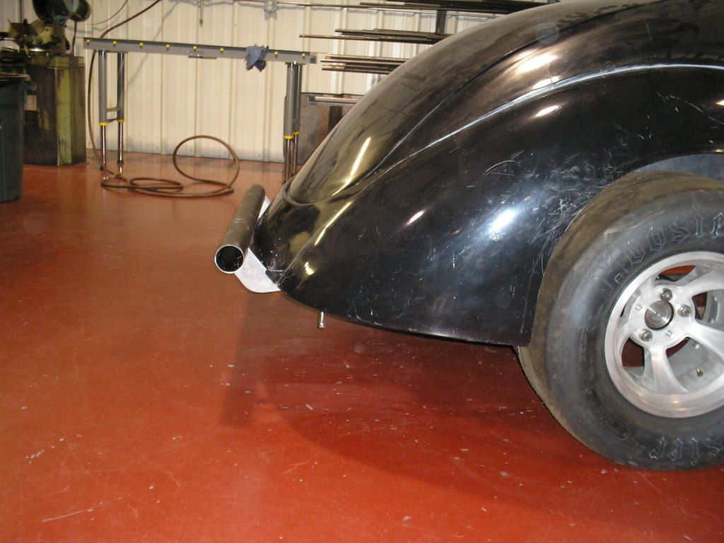

    Another angle [​IMG]
