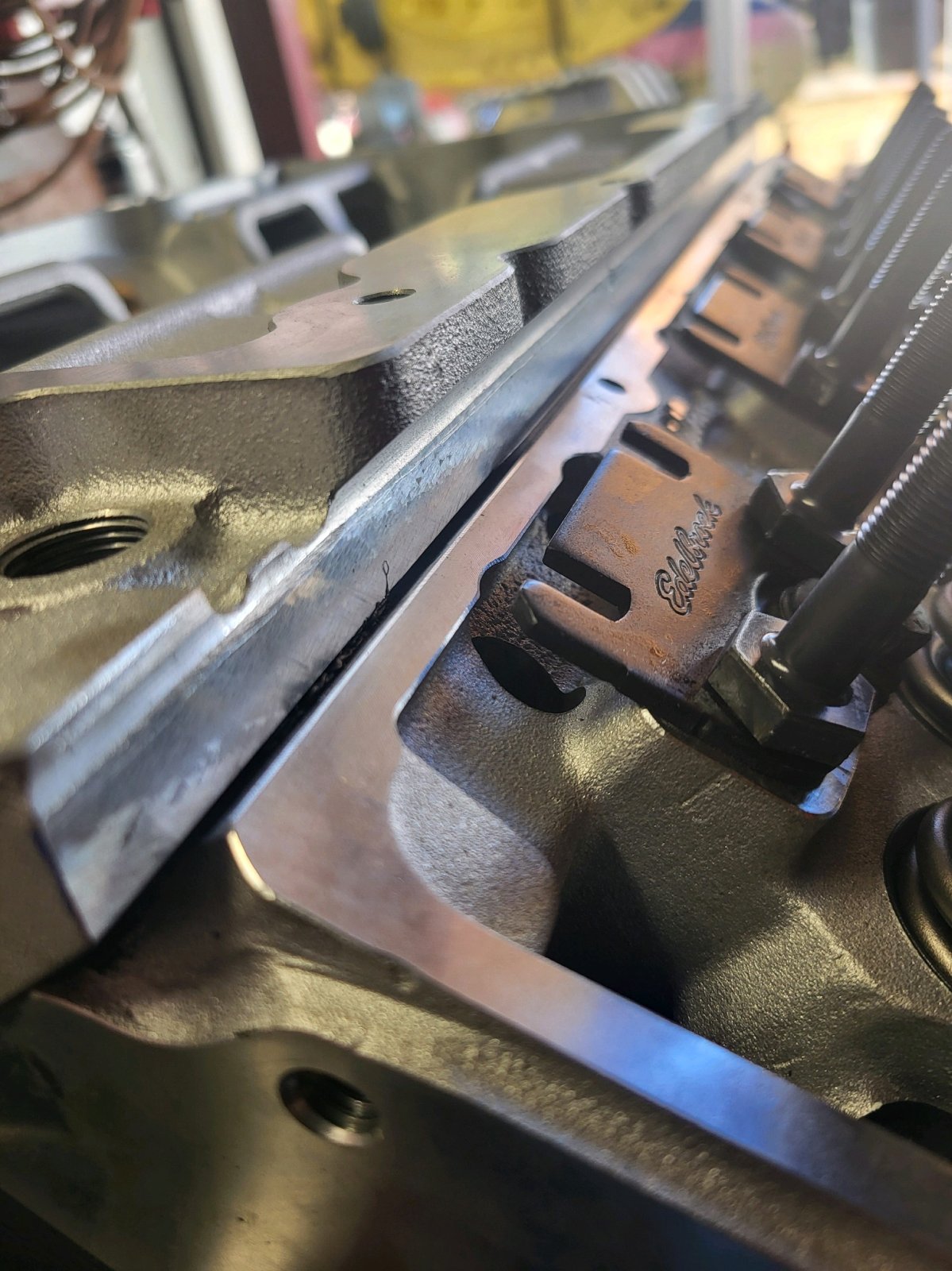

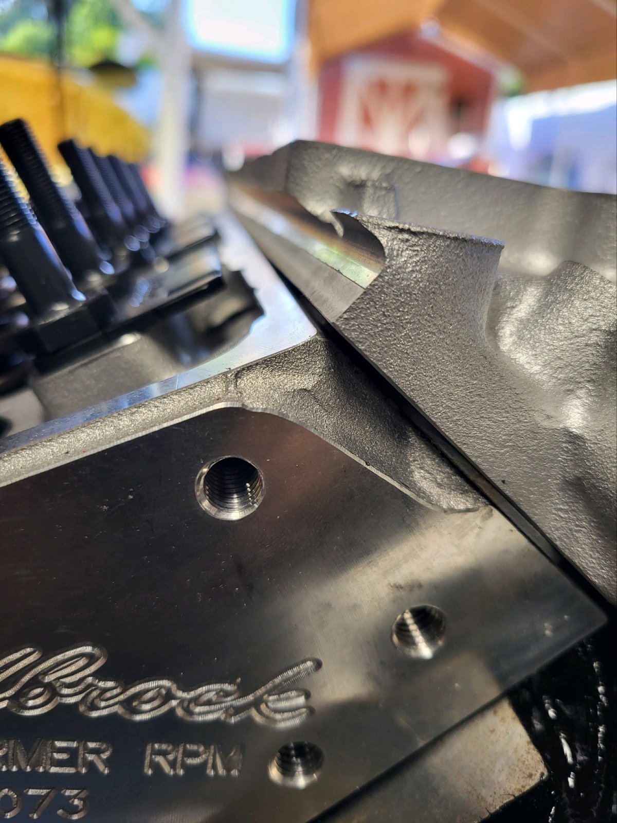

    32017.jpeg 32018.jpeg Also had another issue...same engine , same company. There is no way the valve covers would have ever seated with that big overhang. I'm pretty sure the CNC missed a step. All fixed now.

    Have you check the blower mount surface yet?

    Yes it was all good.

    I ***ume you are talking about the end of the heads and the lack of area for the valve cover to fit down over it, but the intake was going to hold it up even worse.

    Yep we machined the sides of the intake.... no way valve covers were going to fit.
