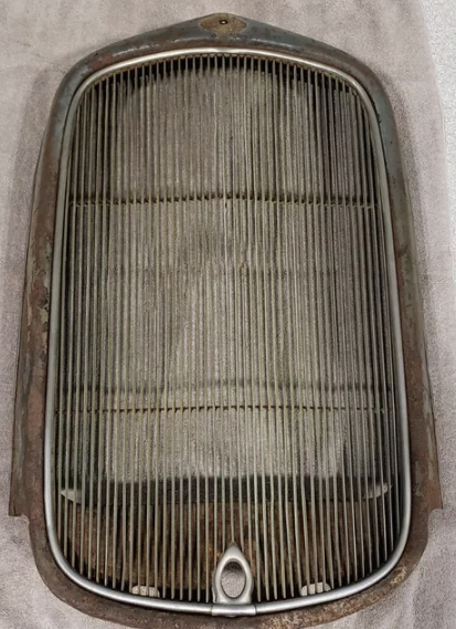

    F262EB69-B139-4341-A615-6B89A1C5D918.jpeg The world seems awash with 32 grill shells of varying quality and cost, and I’m not convinced there is a good correlation between the two. I imagine HAMB members represent a good portion of the customer base for both original and repo shells. I’m in the ~$500 space for an original or original-looking shell and insert, and I’m able and willing to do a little tin-smithing if necessary.
    what are your experiences? Quality brands that you’d buy again, s****s that you pieced together, loans you took out to purchase one of Henry’s? Is it even possible in that price range? Let me know.
    yes, I know that the search function is my Friend, but I’m lazy and, who knows, this might be a timely subject :)
    thanks in advance

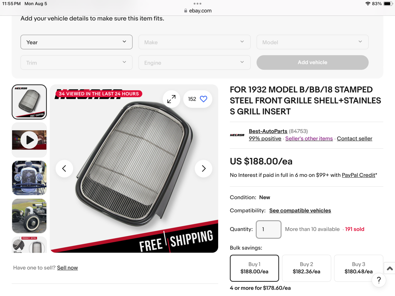

    IMG_4187.png Anyone take a chance on one of these…yet?

    $188 for the grille and shell?! Wow that’s cheap.

    Cheap even in comparison to the ebay junk I’ve been searching. Probably 30ga sheet :)

    Tempting as a wall hanger…and only costs 188 Biden bucks!
    Have an original insert, if it fits, cool, then I’ll sell the repro insert.
    If the original doesn’t fit…should be able to get the repro insert to fit, one way or another.
    Either way, should be fun to lightly “patina” the shell in gloss black!

  18. It is the same one in the link that I posted just above you...
    I physically bought it, it isn't bad it isn't great but you get what you pay for. I would say it is made out of probably 20 gauge steel, it has a lot of shape to the steel so it's pretty rigid.
    My Model A pickup I am building a vehicle that I plan on driving the wheels off of on a tight budget so I'm not worried about it looking like a show quality piece and this one is pretty nice for what it is. The only thing I wish it had was the crank hole to look more authentic and less 1989 street rod but I will live with it.

    Actually bought one of the $188.00 ones, but bought it from Amazon, because it was returnable. Was $197.00 with tax, and came with the insert installed, all though it said hardware wasn’t included in the info! Like ARA said, it’s sort of light gauge, but not real terrible overall, but everything is just off a little. The sides are wavy, the horizontal bars are just a little crooked, the vertical bars are just a little funky, and worst of all to me, the stainless surround just doesn’t look right…it’s size is a little too large (diameter) and just looked funky. The installed insert was in there, but the fit was not that great. Seems like they probably started to install the inserts because of past complaints…at least they are trying! Oh, and the sides of the shell seemed to flair out more than they should, so I’m not sure how the hood sides would jive with that.
    I sent it back…just got the credit today, (no h***le). If I really needed a grill shell, and was building a rough around the edges Hot Rod, I might have keep it.
