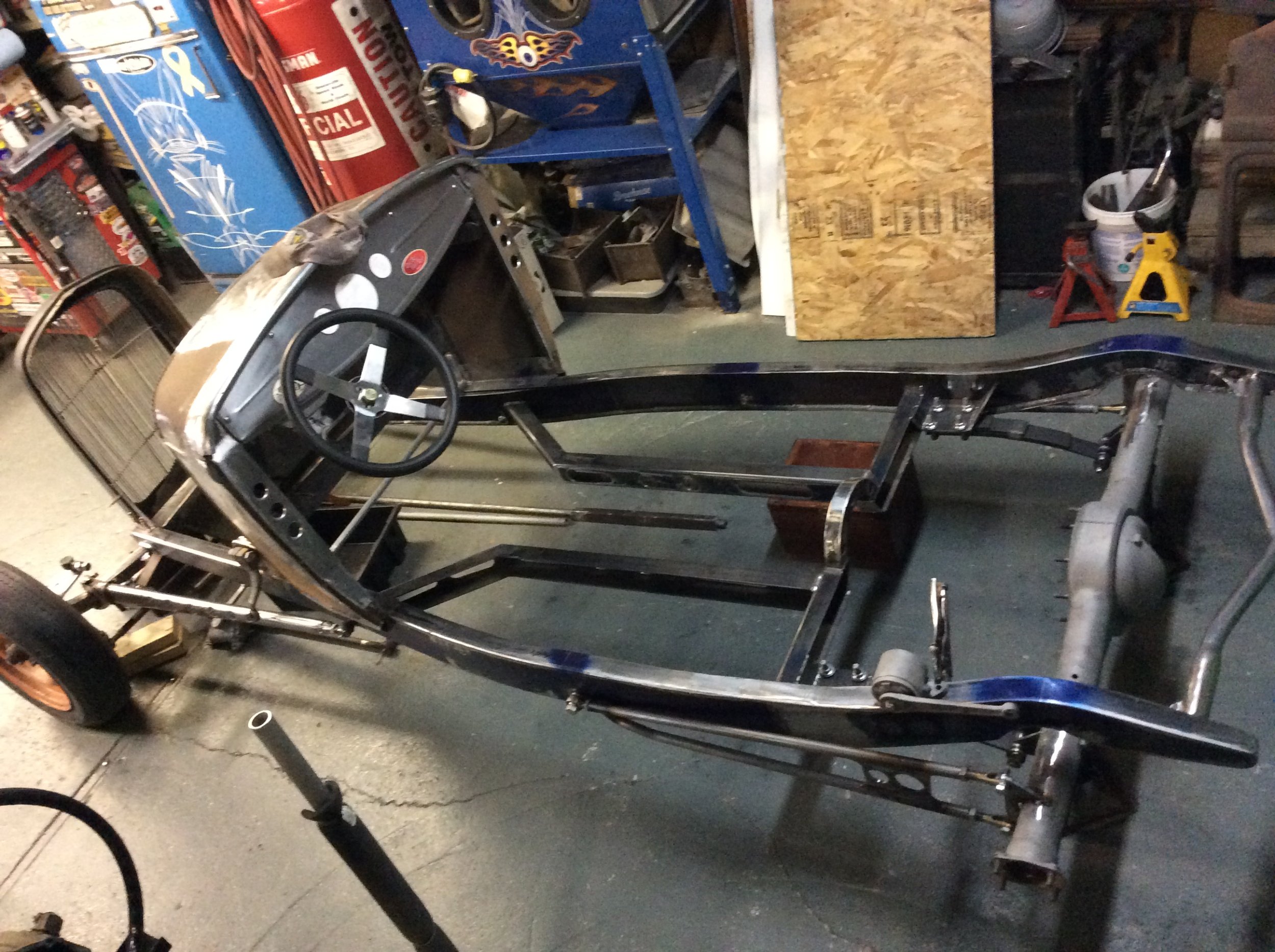

    This is quarter elliptic on the front, no stabilizer bar, no panhard bar, handles like a slot car.

  18. gimpyshotrods
    Joined: May 20, 2009
    Posts: 24,487
    gimpyshotrods
    If spring rates and length are equal (which rarely is the case), the only restrictions to body roll in a QE setup that are not present in a cross spring are spring twist and spring deflection. Both can be mitigated by articulated shackles.
    The handling differences are more from construction/configuration variances rather than design function.
    The car that I built, shown above, has shackles with Currie Johnny joints on the shackles. The brackets on the axle mostly hide them.
    There is nonedible body roll, but it will seamlessly articulate over road irregularities.
    This car was finished out of my control, and had a tube axle and friction shocks. I could not drive it.
    The customer came back to me and I reworked the entire front end, including the steering, and added a beam axle, and tube shocks.
    Later, the rear got c-notches, tube shocks, and a dead perch.
    Now the chassis is done. The 4-71 will come when I get out of the wheelchair, and finish PT.
    rod1 likes this.
