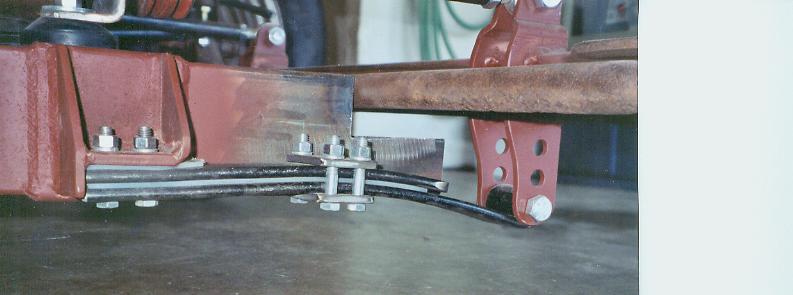

  19. nobux
    Joined: Oct 19, 2002
    Posts: 648
    nobux
    Here is a picture of how I did it with my old frame. I welded a pocket to the bottom of each frame rail. The springs are sandwiched into that pocket and located by the center bolt. There was NO side to side movement. I cut a F-100 leaf spring in half and drilled new center bolt holes. I did it this way so that the frame looked cleaner than mounting them on the sides. With the shackle, the frame rails sat lower than the axle.

    Dont you need a shackle on that?

    Not if it is a locating link.
    The springs create a 4-bars arrangement.
    And you don't need a Panhard Bar.

  24. jj mack
    Joined: Mar 22, 2007
    Posts: 735
    jj mack
    Not really...the spring lengthens (from the mounting point to the eye) when it is flexed. With the upper "bar" maintaining a fixed length, the lower (spring) expanding and contracting...the angle of the axle will change..........
    If shackle will allow this movement with out effecting the angle.

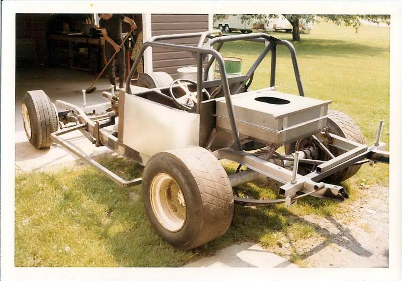

  25. Here's how quarter elliptical springs were mounted on Northeast Dirt and Asphalt Modifieds in the mid 60's to early 70's. This is a pic of a car I built in the early 70's.
    Transverse mounting using the original shackle pickup points on the stock radius rods.
    Springs have eyes on both ends and pivot in the frame mount. Use a panhard bar or weld one shackle to control lateral movement.
    The weight jacking bolts were to "wedge" and tune the ch***is set-up. You could move these closer together to soften the spring rate.
    It's compact and isn't hangin' out there in the breeze as with longitudinal mounted springs

    DAMN! That's ALOT of setback.
    So the white 'posts' sticking up on the front crossmember are the adjusters / weight jacks? I'm looking on a smaller screen than I'm used to.

    Modifieddriver, a clever setup. One question: Is the axle one piece or jointed in the middle?
  28. The axle is a stock '42-'48 p***car. We used them 'cause they were the widest (KP to KP) old FORD axle and had the most drop of any stock axle. Not split in the middle. The old Allard sports cars had that and is was a disaster for camber change. FatMan and some others offer some PoS that's like that.
    The white posts sticking up are threaded rod. Can't remember the diameter, but whatever it is, it was an overkill. Welded a nut to the 2" x 2" square tubing crossmember (I put it inside the tubing) and another nut to the end of the rod at the top. Crank the bolt up and down to adjust ride height initially, then once that's done (front and rear) then you can adjust the wedge.
    There's a jam nut to lock it all in place to the crossmember. Worked like a champ.
    I'm more weight concious now then back then. I'd use smaller diameter rod and shorten them up to about 1/3 the length you see there. I think we eventually did wack them off shorter.
    AND Yeah, the engine set-back was 18" from the front axle center line to the face of the engine block. The car after that had 24" and it still wasn't enough (for dirt). The frame in the pic is a '53 Chevy p***car.
    I included a pic of the rear suspension. A similar adjustment with a roller slider on Chrysler leaf springs. Back of the frame was kicked up to get more rear suspension travel.
    Here's a pic of the completed car. I eventually ran 427's and 454's in it.

  30. jj mack
    Posts: 735
    jj mack
    Look again, The reason it works on that car is....they use a spring on top and bottom....so the axle will stay at he the set angle as both should flex together. the pic above will not keep the axle on the same angle.
    To prove it put the car on blocks...the axle and wheels should drop to their lowest point. Put an angle finder on the axle. Then use a floor jack and jack up the axle till the car is just about to come off the block...this should be the highest point.
    Ill bet you a beer the angle changes as the spring straightens out.........
