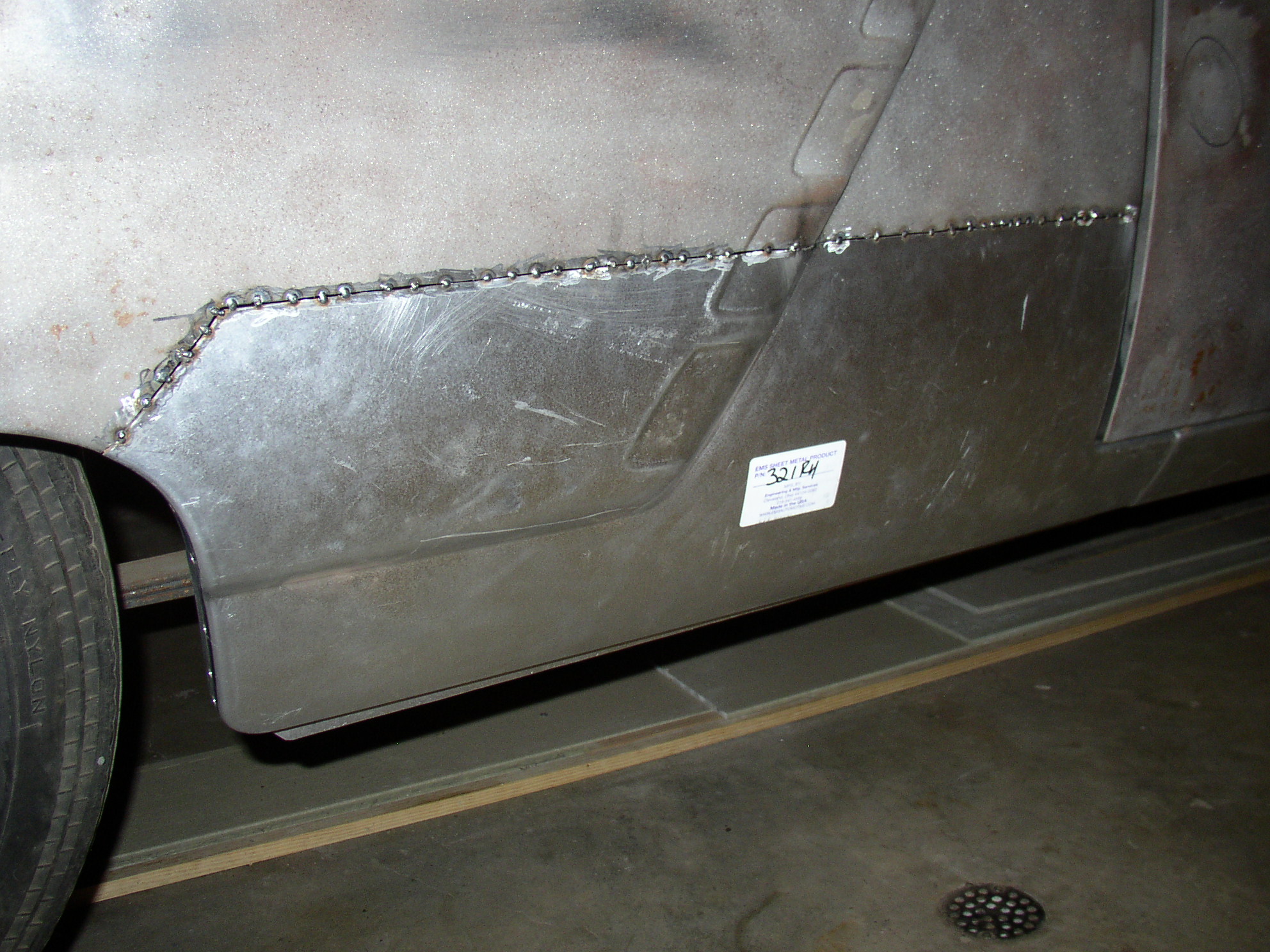

  8. This is how I did the quarter panel section on my 53 before I bought my new tig. Leave a gap the thickness of the metal and tack it in. Weld between the tacks a little at time. My 53 8.JPG
