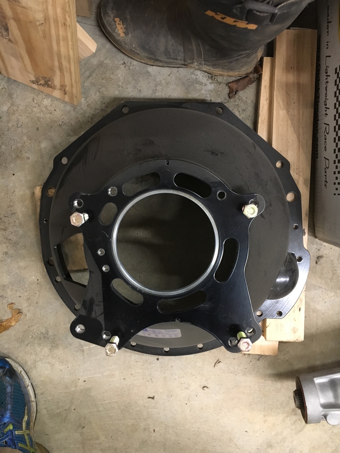

    I’ve got a wilcap adapter behind my 390 now but I ran across the QuickTime and they look a lot less bulky and of course extra safe compared to an aluminum bellhousing. The motor is in my 32 vicky and any extra floor room is nice!!!

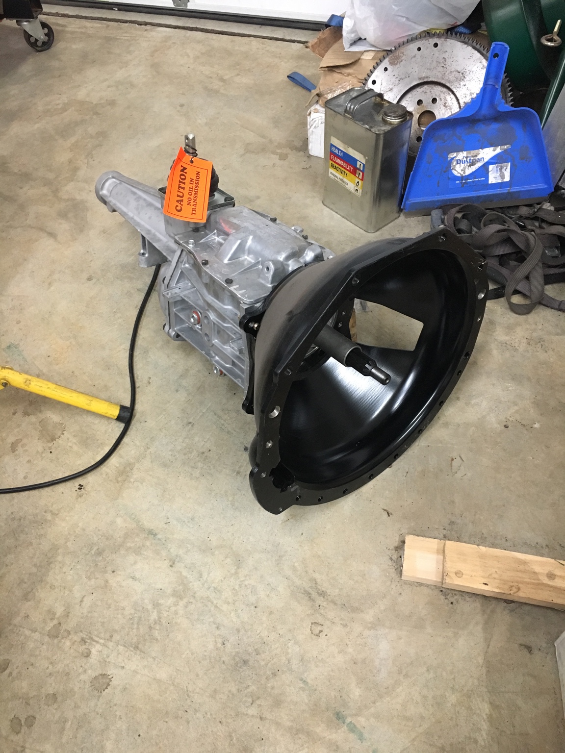

    I’ll send you some pics... I have a QuickTime for my 331, and it fit up great... engine is on stand now, but Its profile is narrow compared to adapters

    Thank you ls1yj for not only the response, but the pictures!! Overall it looks like a better fit than adapters!!! What part number did you use? They only offer one I think?

    I can’t remember the part number, but like you said, they only list the one for 365-390 cads 55-62

    Part number is RM 8025

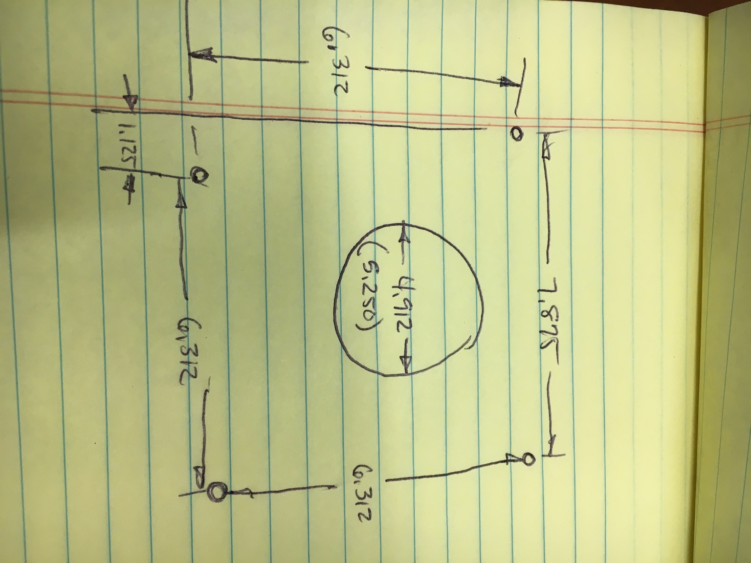

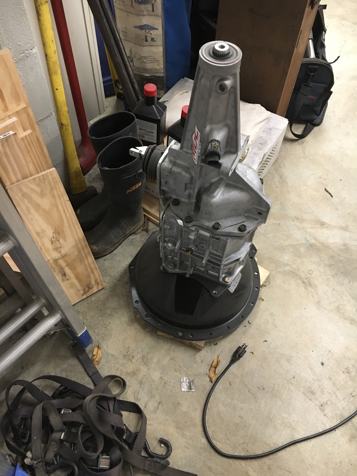

    Here’s a pic without T-5 [​IMG]
    And a pic of scaled quick dimensions
    Torkwrench likes this.

    Definitely looks like no Muncie/ t5 GM pattern......bummer.

    If you were feeling adventurous, the mount plate is healthy 3/8 HRS, and could be altered with some ears to give you room to add hole pattern you need

    Just wanted to throw a lil blurb
    out about the sketch I put up awhile back... it was just a quick scaled drawing, to see if a guy’s T-5 would fit this model and hole pattern... I did not take great care to get precise dimensions, so I’d recommend getting a machinist or other to grab a little better numbers before doing any machining.... sorry for any confusion
