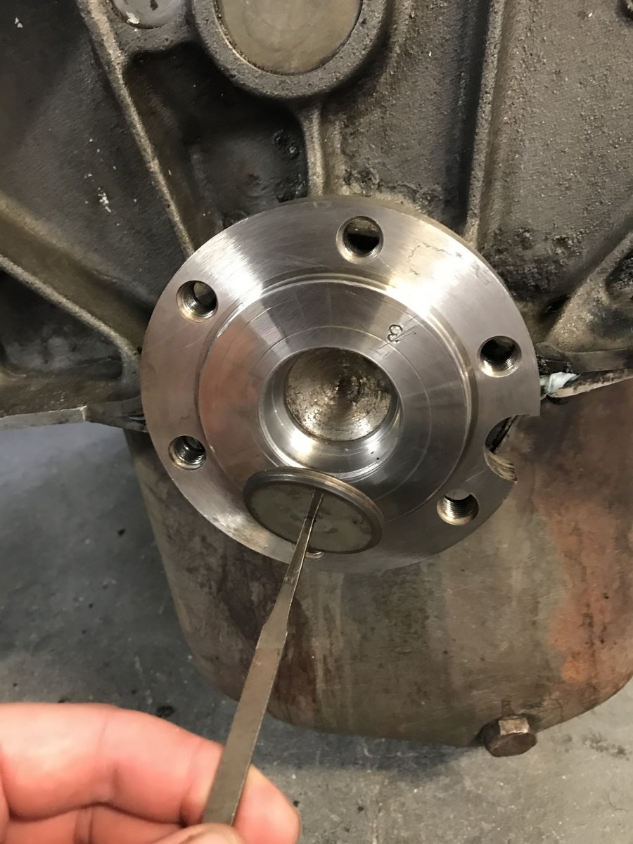

    Started installing a QuickTime bell to a 57 365 last night. I was basically looking for a good deal on any trans that would work with this bell housing. Came across a used Ford style TKO 600 that the guy had switched out for an automatic.
    There is this disc just resting in the end of the crank which came out with no issue.

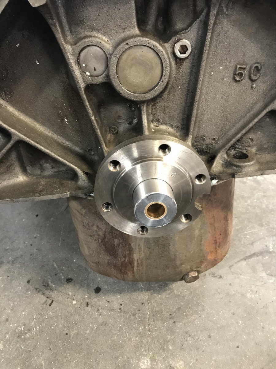

    Purchased this pilot bushing from Wilcap that he added a ford size bronze insert to.

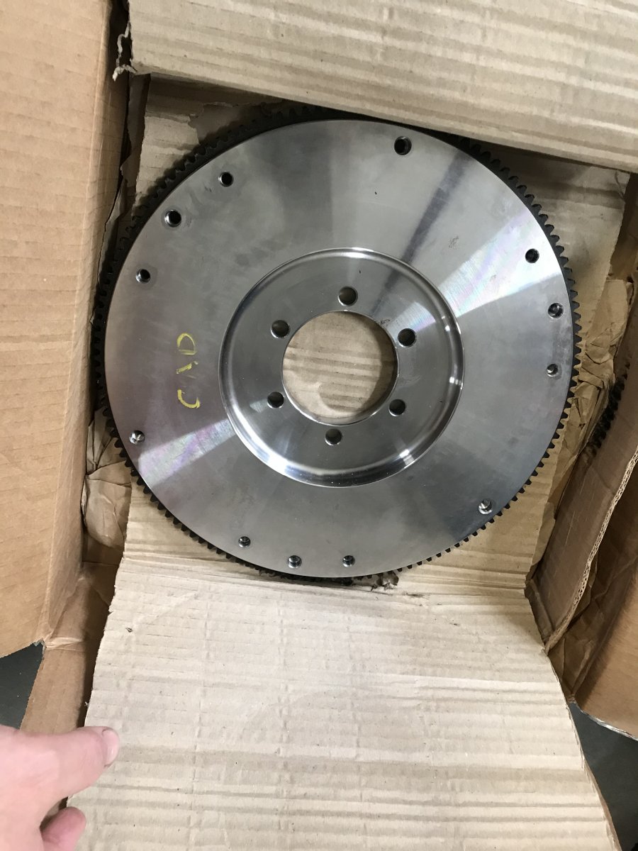

    Wilcap 130 tooth flywheel

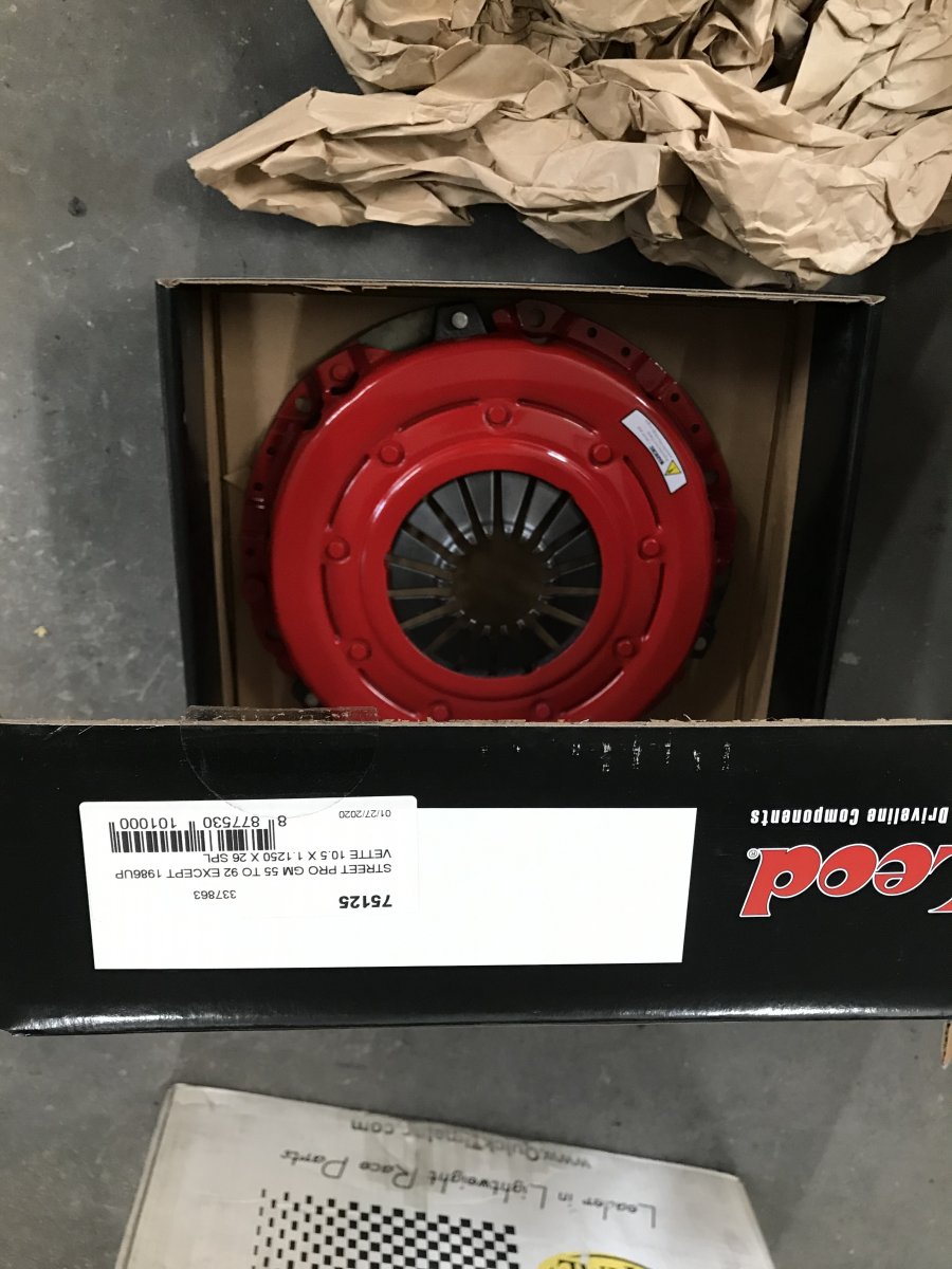

    Mcleod clutch and pressure plate kit. For some reason it was cheaper to buy this GM kit and then purchase a Ford throw out bearing separate.

    The pilot bushing needs to be flush with the end of the crank for clearance.

    Yes I had to cut the pilot bushing down to a little over 1/2” in length. The collar to clutch hub clearance was about 1/4” , I didn’t trim it any hopefully that’s enough room.

    I just noticed that this flywheel appears to have a lathe turned finish, rather than Blanchard ground.
    A ground finish is generally considered a better clutch mating surface.
    I used to grind flywheels at an auto machine shop, and we only lathe turned them when the flywheel was a deeply recessed type that didn't fit on our grinding machine.
