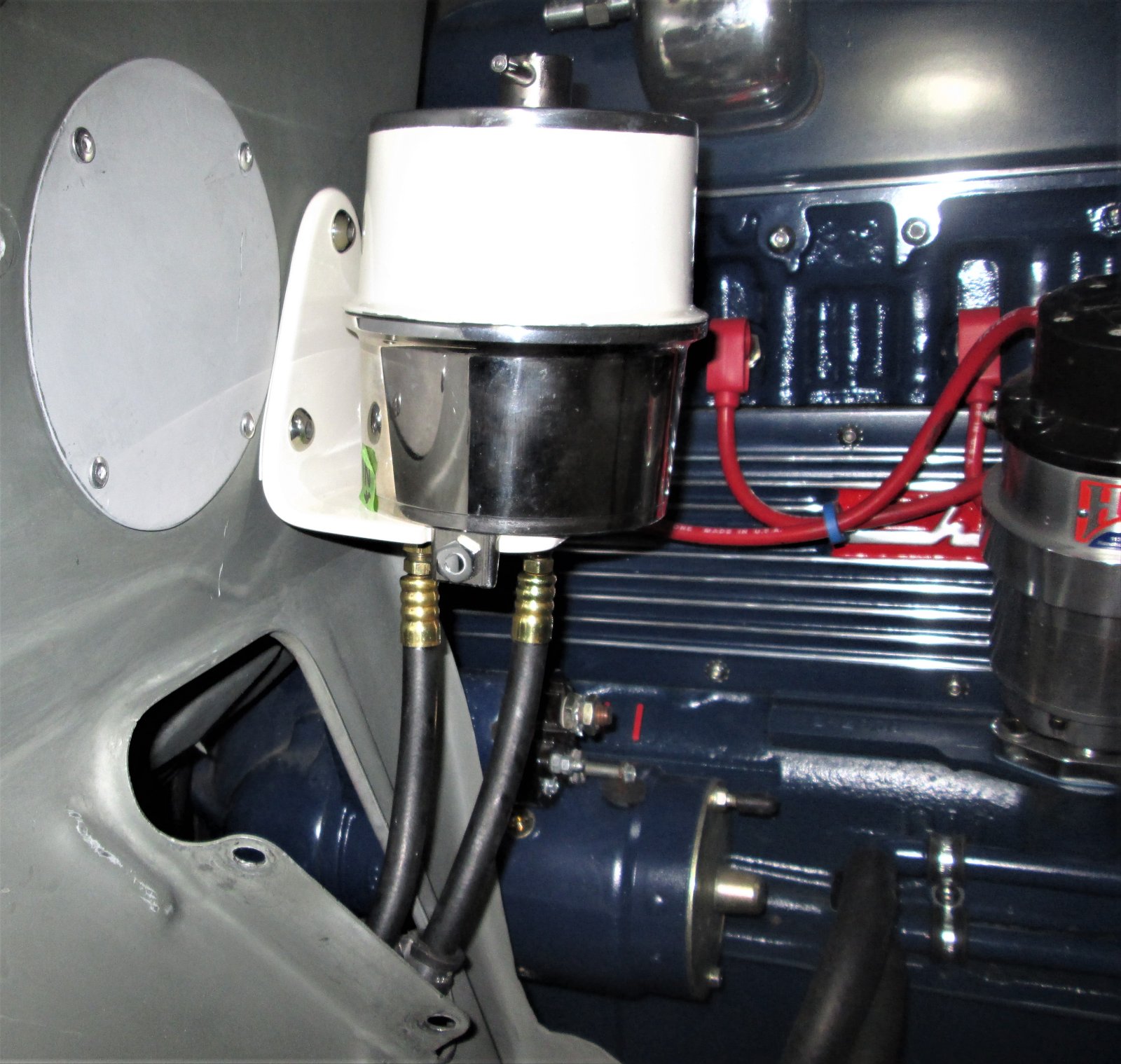

    I’ll bet he wants us to identify the white and chrome thing mounted to the firewall with 2 hoses connected at the bottom. Nice hose crimps by the way!
    I only like black spark plug wires but that’s a personal choice.

  10. Coffee pot.
    Uses engine oil heat

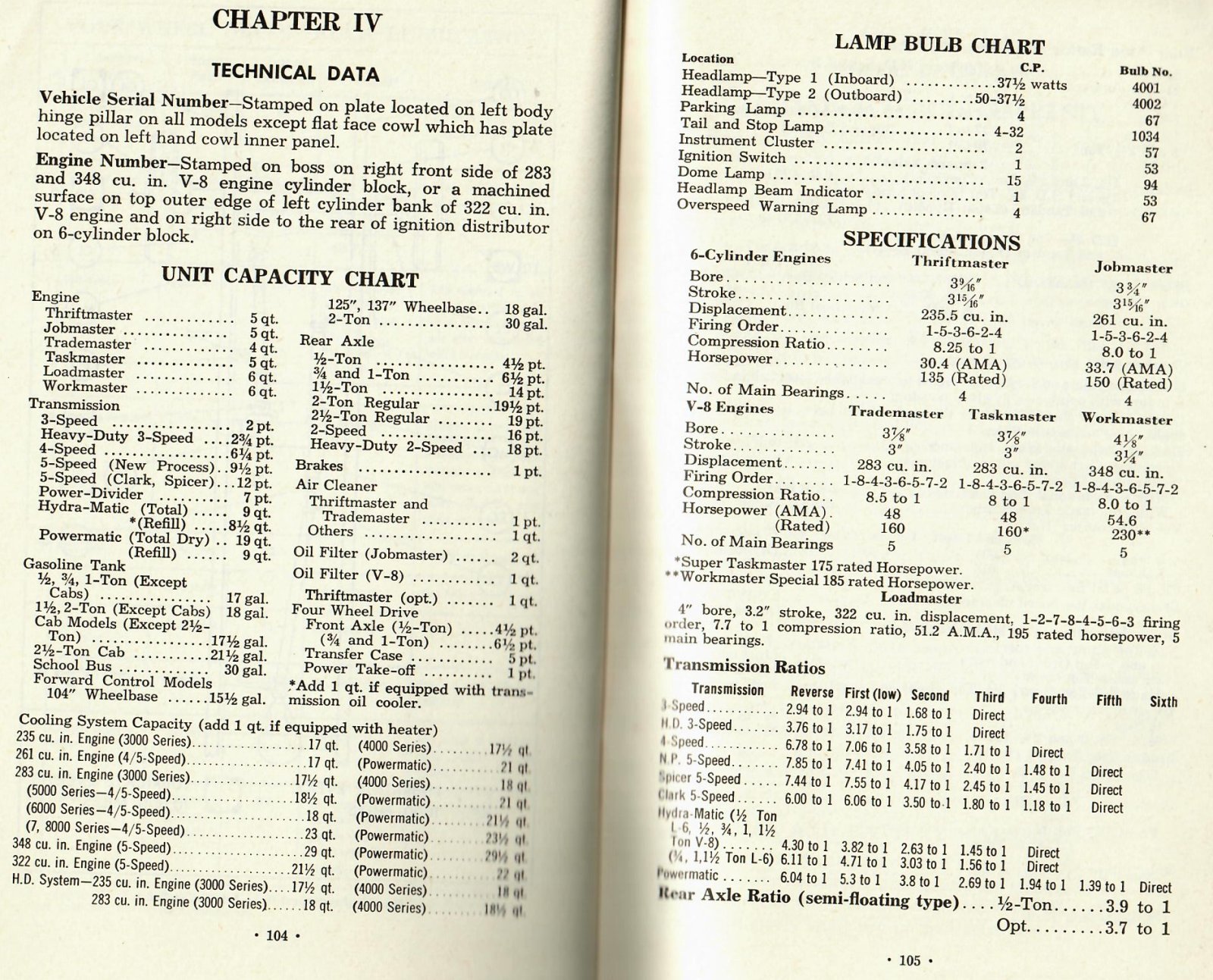

    Screenshot (771).png Screenshot (773).png Well hell, you won't find 1960 engine specs in a 1954 book.
    If it is a 1960 261 out of a C 60 the pan holds 5 quarts plus the filter 5-1/2 quarts on a freshly ***embled "dry" engine. according to the GM heritage center vehicle info kits archives.
    https://www.gm.com/content/dam/comp...its/chevrolet-trucks/1960-Chevrolet-Truck.pdf
    Below the image from 1960 is the image from 54.
    That and most years you can find here. https://www.gm.com/heritage/archive/vehicle-information-kits
    The 54 truck page being here https://www.gm.com/content/dam/comp...its/chevrolet-trucks/1954-Chevrolet-Truck.pdf
