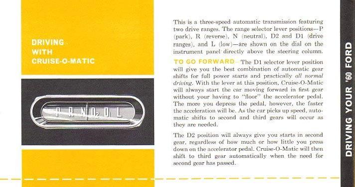

    Is your kick down linkage working right? Are you using the center position on the three drive options(marked D1 on some)? The left or D2 position starts you out in 2nd.
    Damn I have to type with more than 2 fingers, What Steve said.

    Use the one in the middle(big dot) for all three gears and check to see if kick down is working properly.* sorry I didn't catch that the kickdown is working

    That s a Plan . First i was thinking That all the 352 is so slow. But i think its only Mine :) I will Check all and will Tell u. The downshifting is OK .When i accelerate it shift down and i think....wow the Power will press me in the Seat ...But nothing :) Its only Loud...Thanks a lot
