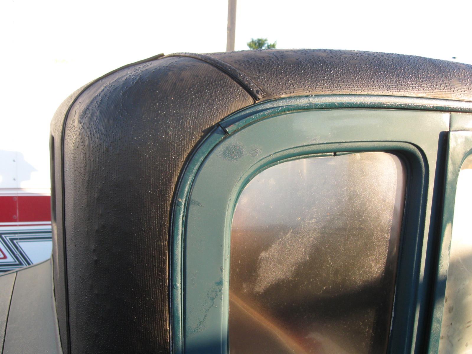

  27. 68Camaro427
    Joined: Nov 23, 2011
    Posts: 42
    68Camaro427
    Red, here's a shot of the back gl*** area. The top looks like **** (funky creases, etc) and the drip rails are just awful. The brown Special in a previous post is absolutely stunning, so if I can get parts and a decent top on this that looks even halfway that good, I may stick with it.
  28. alchemy
    Joined: Sep 27, 2002
    Posts: 22,825
    alchemy
    It looks like your special coupe is kinda special (not all there). I bet whomever redid your top ruined the original drip rails and trim moldings, as well as did a piss-poor job of stretching the fabric. As a matter of fact, the rear window looks a little too square on the corners. Maybe they replaced the wood underneath in a poor fashion also.
  29. 68Camaro427
    Posts: 42
    68Camaro427
    Yeah, I'm almost afraid to peel that top off. Right now, the car's kinda like a 20 foot paint job, so, at the risk of having it look worse, I may leave the top alone for now and just drive it while I'm working on the other ch***is.
  30. Reds 29
    Joined: Jan 16, 2006
    Posts: 473
    Reds 29
    It appears to be a special coupe, the belt rail appears to be there, and the area around the quarter windows looks like a special coupe. I agree the corners of the back window look too square, maybe the wood was replaced. When you're feeling lucky take the top off.
