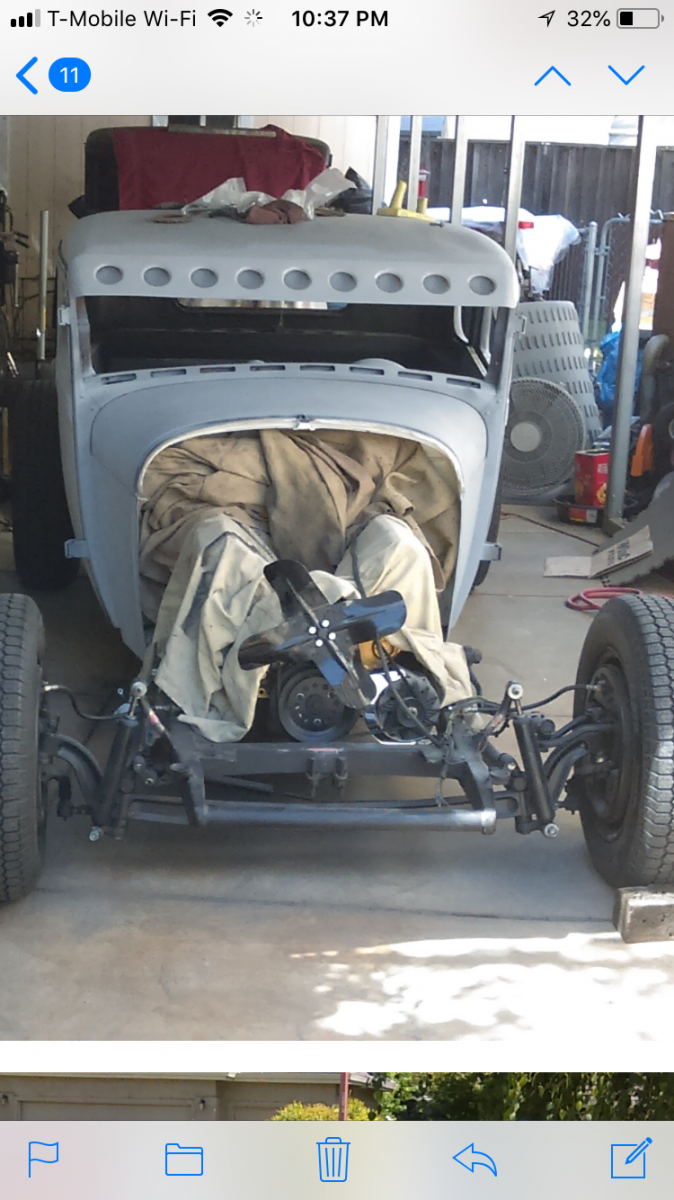

  7. Only pic I have that you can kinda see the front end. But it does NOT have those shocks or mounts anymore.

    You have not added enough pics for others to really help. Your only poor pic shows front spring shackels that are not fully loaded yet with the rest of cars front lbs. =when they get full load,they will be down too far{not at 45*} =that if shackels are now hanging lower then 45* and front axle has no panhard bar it will shake/so also if rear axle set up same way with out a panhard bar. More pic's could show other probs as well. To those that can see things you don't know about an there for can't see,it's why those that wish to help ask for photos.

    Agree, Dana. With more load the shackles angle down toward oscillation. Panhard would help, or spring length-recurve.
