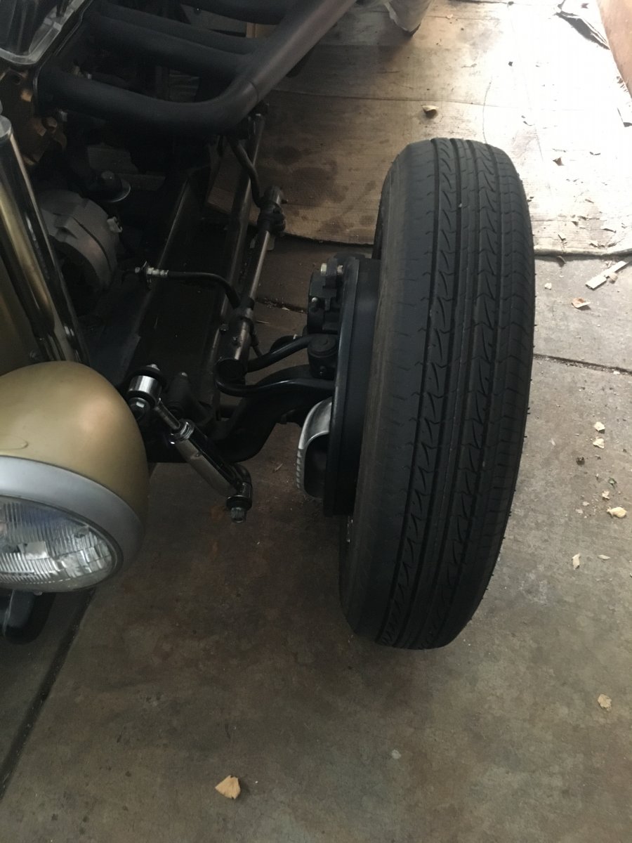

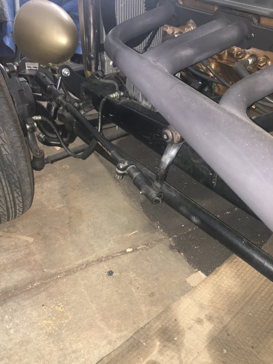

  4. Shackles look to be at a good angle to me. The spring is slightly angled but even before the flat crossmember is had this problem. The front suspension moves up and down just fine.im not really concerned about that part.
    It’s a SoCal axle with a posies spring. I bought them together so they should be the right setup
    Picture shows things more crooked than they actually are. Not sure why the shock looks goofy
  5. I can push on the driver tire and it APPEARS the tie rod flex’s s very small amount. I need another person to check it better.
    And the front caster is indeed 8 degrees I just verified. Tie rod is angled from heading the steering arms,but I don’t think the tie rod knows that. Spring has a slight angle,doubt it’s causing the issue,just something I observed

    And there you have it. More than about 5 degrees can bring on death wobble, depending on the rest of the geometry. 3 degrees doesn't sound like much at all, but I have seen dialing back a little caster stop the wobble on race cars. Won't happen under hard acceleration, but can really pucker you in the shut off area!

    Sounds like death wobble that's masked by the dampener. Don't know WHY you wouldn't have a panhard, but without it the axle WILL shift as shackles and bushings are meant to move by design.

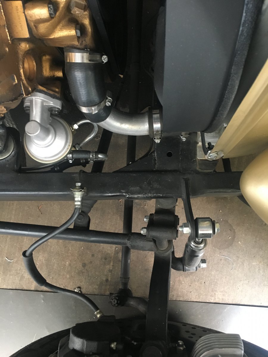

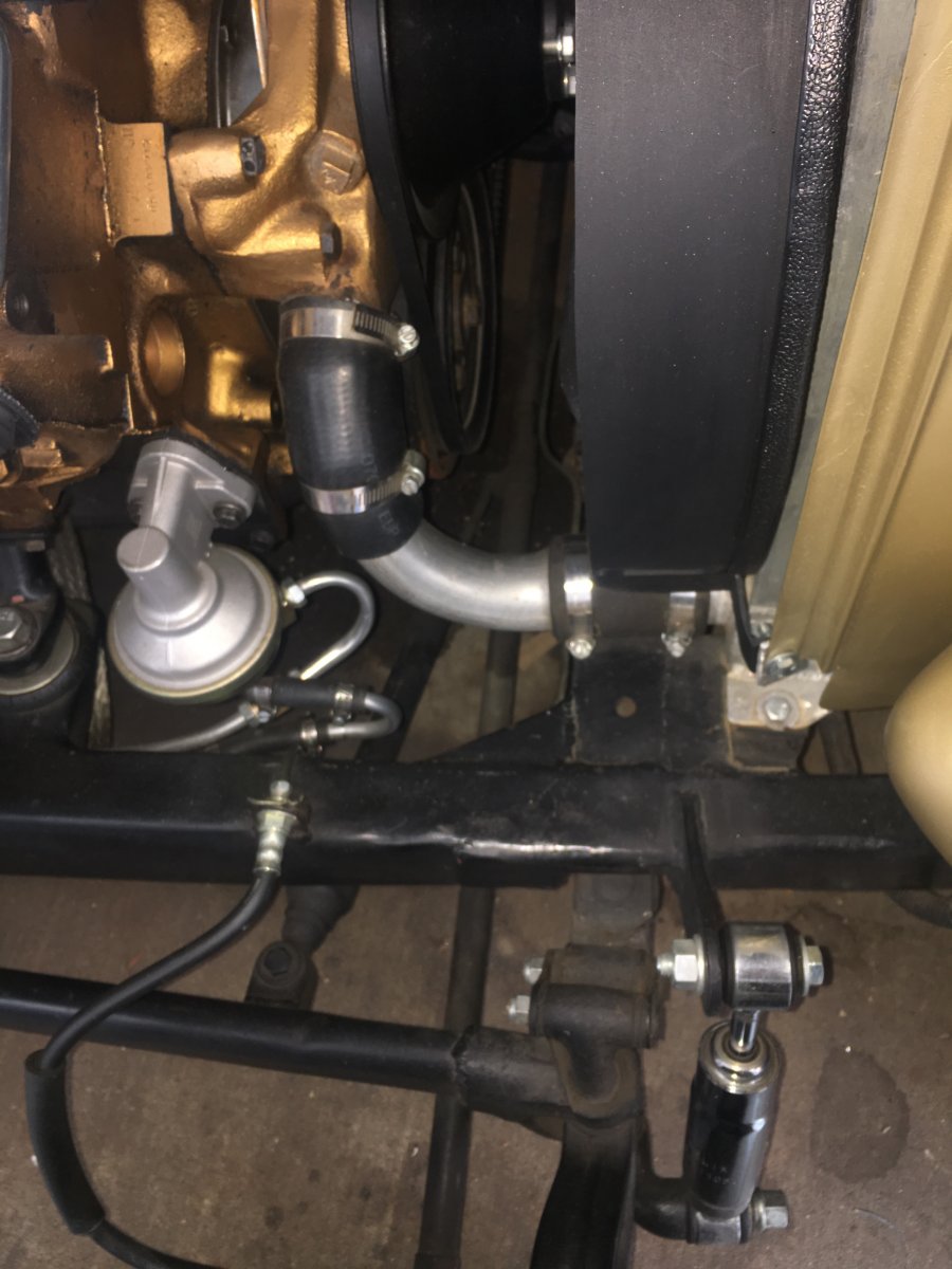

    After looking at your picture, the one thing that stands out to me is your front shock absorbers. They appear like they are almost bottomed out because they are too long. I also see someone has modified the top mount by extending it to try and make this shock fit. You don't even have the radiator and coolant in it which will make the front go down even further. The first thing I would do after checking for any play in the front end would be to call up one of the specialty shock manufacturers and get the right length shock setup for the weight of your car.
  13. You guys really need to readwhat I said,. I commented that first pic is not the same shock setup as now. The ones I just posted are current. They are clearly not close to bottomed our not ‘modified’ they are different mounts and shocks entirely

    Thanks for adding some photos,an yes by those, your shackels are a bit lower then 45*so can let axle float{jerk too side in a bump= needs a panhard bar on. If your rear/****,check rear bar for play too. Just as a side note,I see the front shocks are close to straight up,so with out more lean of at lest 15*,they don't work to also help axles shift,so with the combo of shackels being low and shocks not helping ether=you need a panhard bar or fix one of both.
  21. See,this comment makes sense to me.the shackles may be a little more that 45 I can’t get a anglefi see on them.
    My shocks are at 23 degrees though.
    I’m also thinking the crossmember was welded on at 5 degrees and my wishbones are a bit short causing that spring to look a little twisted. I’ll have to cut the bone mounts off and move them forward a bit and go back to 5-6 degrees or drill holes up higher.unrelated,just a thought

    You have incipient death wobble - it just hasn't gotten as bad as it might, but its the same animal.
    Connecting the stabilizer to the wishbone is worthless - it needs to be hard anchored to the frame. Whether the stabilizer itself is any good, I don't know.
    I think you have one or more other contributing elements such as shackle angle. IMHO shackles are intended to control the axle IN CONJUNCTION with stock wishbones. Add a panhard bar or bell crank.
    Yes, you want to maintain 1/8" toe IN. If your tie rod is so weak that it's bending/buckling in use, t5hat's an obvious problem and obvious fix.

    No way! If you attach one end of a steering stabilizer to the frame the bit of rocking the axle does on the shackles will induce a kind of bump steer.
