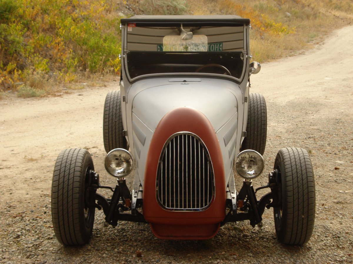

    Ok here ya go, looking at the photo provided, it appears like your steering damper is off. It also needs to be parallel to the axle. Also, if my old eyes aren't giving me headaches, it appears that the right side is off, axle to crossmember. so- - -straighten out the damper, square up the axle to frame and check the tightness of the front perch bolts. Another thing, I also noticed that you have the very old drag link with the spring inside behind a cup that fits over the stud ball. That old system is what gave the old fords and other makes such lousy steering. I'd replace it. Speedway makes tubing at different lengths that would work. Actually, tie rod ends are tighter that the old ball stud and cup tie rod.
    I had a really bad case of "Torque Steer" a while back and it all went away after installing a panhard rod. So give it some thought. This is just some old advise, measure- - - - measure- - - and write everything down. A build book can solve questions down the road. Good luck and I'm going to stay with your problem to see what remedies you came up with. Jon

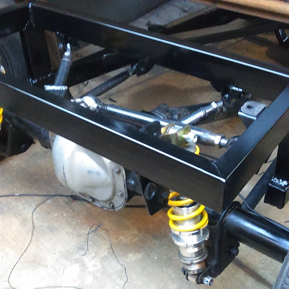

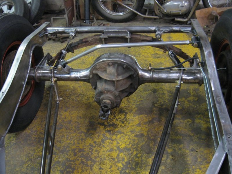

  28. Look here >> https://www.jalopyjournal.com/forum/threads/rear-suspension-ideas-please.1072176/
    That short panhard bar with triangulated 4 bars is your current set up?
    That short pan hard bar will yank the ch***sis and body and you to one side every time it goes over a bump.
    If so, take the panhard bar off and go around the block over some bumps and try it.
    That thing is way too short, and you do not need it with a triangulated 4 link .
    The pan hard bar is fighting the 4 link at every bump.
    57 Fargo likes this.
  29. The Pan hard bar should be as long as possible.
    This one could be about 8" longer and be better.
    Again hooligan, that set up from your earlier thread does not need one but If you have to have it, A pan hard bar should look like this one and even longer
  30. 31vicky... I said it has truck arm rear suspension. That stuff in that picture is long gone.only the axle itself was reused.
