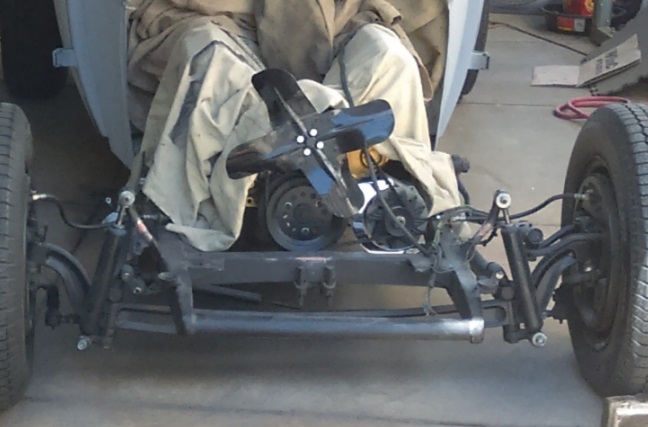

  1. That drag link is very tight. It’s actually new.the ends are not rebuilt but it’s actually all new stuff. I can’t exactly use a tie rod on my steering arm. It’s a stud
    And the damper is correct. It’s mounting arm is angled,so where it’s mounted to the bones is where that angled told it to go so to speak. It doesn’t mount straight like off road trucks do,or whatever else (that’s all I can think of to compare at the moment)

  14. Update,did a few things,got the bones mounted at 6* and drove it. No real noticeable change.
    But I found 2 other problems. One is that my p***enger front kingpin has a little play,I can see the bearing wiggle a bit when I grab the wheel. Also (very stupid) my front body bolt was t very tight. It was sort of ‘exaggerating’ the car vibrations.
    The issue is still there but it’s really not all that bad now. I’m still probably going to keep working on some of the front end though just cause I’d like it to be right.

    Model A Hooligan... You keep saying your draglink isn't level.
    You do realize its not supposed to be with split wishbones, correct?
    With a 4 bar suspension yes...but not with split bones.
    Totally different requirements between the two. It is possible to have too much angle and cause tie rod end issues for sure...but being level for the sake of level isn't what you need.

    There ia a very clear view of the right front spring shackle in the pics on posts #&, #34, and#35, and while the angle of the shackle may be a bit steeper than 45*, it sure as hell ain't vertical, or 90*. So the spring IS IN STRESS. With side steer, the small amount of lateral movement possible with this shackle angle certainly isn't going to affect the steering, which is by longitudinal movement of the drag link.

    Without even considering the amount of weight missing off his car in this picture...the shackle angle looks excessive and I don't see lateral movement being resisted much at all, especially when its being driven over humps and bumps etc.
    I doubt very much that a spring spreader had to be used to connect those shackles to that spring. On my T I had to draw the spring into place with the shackle mounts. No need for a panhard there! ;)
    One other thing, he has stated multiple times that there are no steering issues with the car. The cars not darting...just wiggling in the suspension a bit...and its not being transfered into or thru the steering.
