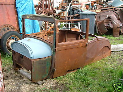

    First is a 1928-'29 Ford, look at the cowl (the section to the front of the door) the gas tank is much deeper and there really isn't much of a defined body line. The cowl on the '28-'29 is also a bit narrower than the rest of the body:
    The second picture is a 1930-'31 Ford. Look at the cowls, the body lines on the doors, etc...

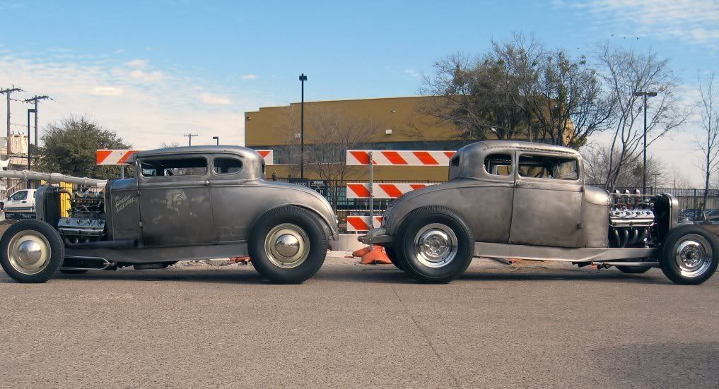

    Well since you asked about the rear end of coupes and everyone is talking about cowls and showing you roadsters maybe this pic will help you out better. Here is a side shot of a 28/29 coupe and a 30/31 coupe right next to each other. Compare and contrast.

    28-29 have flat line/features at the belt, 30-31 are rounded. 28-29 do not have a body line along the bottom and around the rear wheel openings like the 30-31 does. 30-31 door window openings are slightly curved on the upper, the 28-29 are flat. 28-29 have a flat sunvisor and sit slightly below the roof line, the 30-31 has a visor with a feature line, and is flush to the roof.

    looking at cretin's photo, I see what you are talking about the curve of the qtrs, I never noticed that before.

    On the coupes, the 28-29 doors overlap front and back, 30-31 doors flush fit front, overlap at back. The tops are quite different but difficult to tell on the two chopped ones in Cretin's picture. The curvature of the top at the back is different, and the way the cloth roof attaches is different. The 28-29 top material comes down to the drip rail and the 30-31 just fills the hole. The curve of the trunk is slightly different as seen in the picture but the deck lids are basically the same, except for the way the rumble lid latch attaches to the decklid. Also the quarter windows are slightly different shapes.

    Damn that thing is chopped! Wow.
