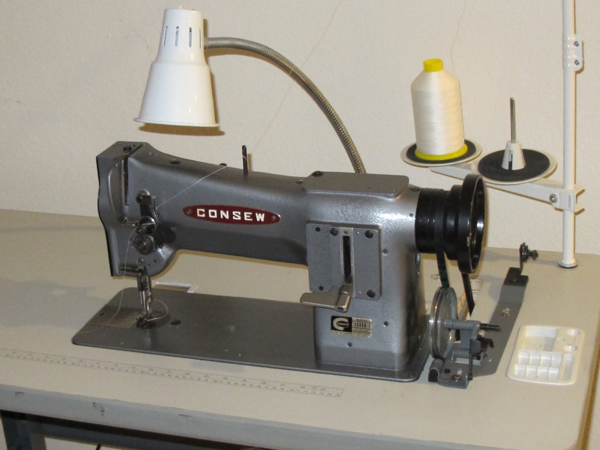

    How can I tell if the sewing machine has a walking foot? and what does that do? HRP
  16. Blue One
    Joined: Feb 6, 2010
    Posts: 11,538
    Blue One
    from Alberta
    A walking foot is pretty much essential for upholstery work as far as I understand it. The foot walks to pull the fabric through the process of sewing and makes thick materials easier to handle.
    Go to you tube Danny and watch some videos and you will quickly see the difference.
    You can get walking foot attachments for a few machines that don't have one but they are a compromise and don't work that well.
    HOTRODPRIMER likes this.

    post 18^^That's a clutch motor, you can see the can where the belt is, very far from the motor itself. That looks like a big clutch/motor
    another couple of differences: Home machine you have to use your hand to lift the foot if you need to. Commercial is foot pedal lift setup, so you can keep both hands on materials when doing complicated things.
    ancient commercial units don't have a reverse s***ch capability, which is faster when locking the end of sewn s***ch. Locking, means going back/forward, prevents unravel
    also comparing home use, commercial guys buy pre-wound bobbins for the lower thread of s***ches. It's faster, but you can wind your own if the box quan***y of pre wound bobbins is too much to ever use, or a less popular color. Many shops seem to use neutral color thread on cloth fabrics around here in CT.

    There is 2 feet, an inner and an outer that basically "walk" or take alternating steps.
    If you lift the foot [feet] , underneath there are "feed dogs" that come up and walk with the outer foot
    on a normal "flat sewer" they use "feed dogs" underneath and the upper foot is basically a ski.
    If it is a "flat sewer" they are selling, don't waste your time or money. You need to learn upholsterery on a machine that is capable of doing the Job [ like trying to weld Aluminium with a soldering iron:) ]
    If you can find one.......Get an Adler [you'll always get your money back later when you sell]
