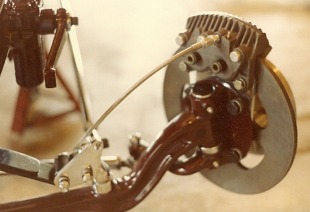

    That looks like the Magnum Axle disc brake kit, initially Vic Leon was Jim Ewing’s partner in Super Bell. Leon left to start Magnum and then he either took the brake idea with him or added some of his own ideas and marketed a kit of his own. The Super Bell hubs had press fit grease caps and Magnum had aluminum caps held on by small socket head screws. The missing rotors were 3/8” steel.
    Here’s a photo from the Magnum catalog, and another from Super Bell-
    Blues4U, squirrel and Algoma56 like this.

    Another vote for Magnum. I have such a setup. Recognise the snout of the hub and the caliper mount. Note that the mount is a cut from plate item and not a cast, shaped item like the Speedway advertised ones pictured. Obviously very similar to the P&J Super stoppers, but the caliper mounts are notably different. Mine has the vented discs which aren't shown.
