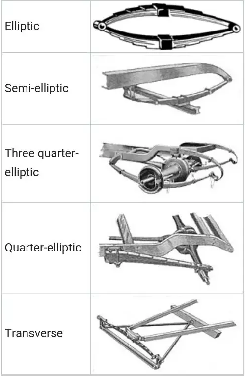

  12. I realize you haven't yet posted a picture of your intended suspension design but I think I may understand why your rear suspension is so hard to visualize. At first I didn't understand why you would want or need a four-link when running parallel leaf springs (semi-elliptic) or why you would intend to mount a shackle to your rear end housing until it hit me ... I think you mistakenly said semi-elliptic when you actually mean quarter-elliptic. Instead of mounting the leaf springs solidly to the housing and the frame like pictured below, you are intending to mount a shackle system to the rear housing, allowing it to "float" while the four-link does the job of locating the housing. Again, just guessing here.
    My other guess is you actually are running a four-link and true parallel leaf springs (semi-elliptic) and you are trying to design a "housing floater" similar to those used by drag cars that run both leaf springs and ladder bars or four-links. Again, just guessing with this one too. The bottom pic is a housing floater.
    Knowing that Model A Ford don't have a lot of/any frame behind the rear end, I doubt you are running true semi-elliptical leaf parallel leaf springs and if you were, you wouldn't need any other type of locating device or any sort of shackle system on the housing but since this frame is homemade and your suspension is of your own design, without some clarification or pictures, it's kind of impossible for anyone to fully understand exactly what it is you are attempting here :)
    [​IMG][​IMG]

    @borntoloze you are correct, quarter elliptical, my auto correct and I didn't catch it.
    I will get a sketch up later today!

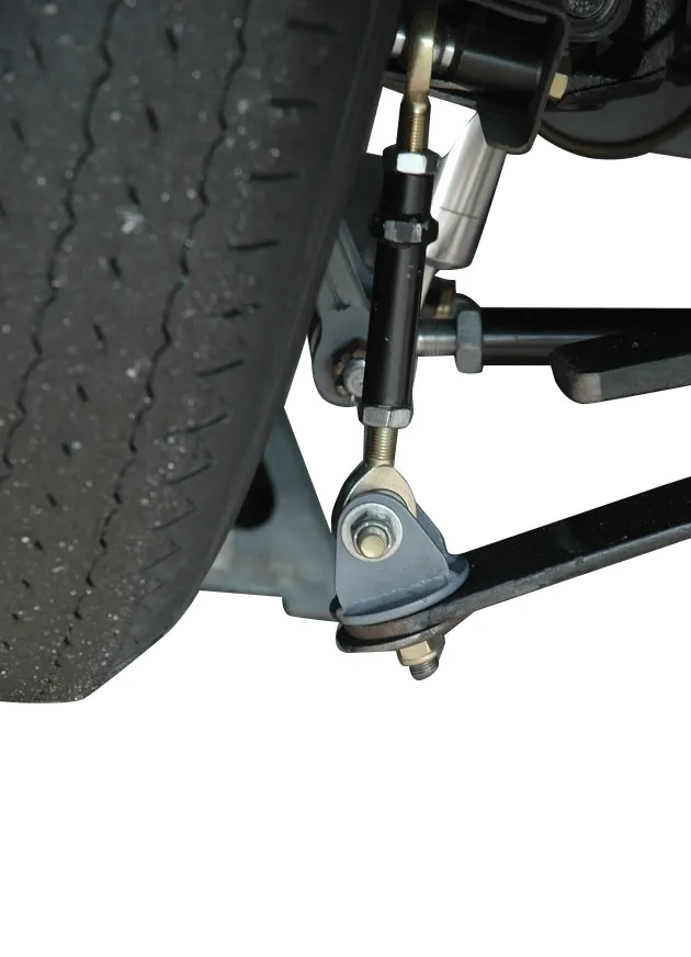

    Are you referring to mounting a heim to a common bolt like the Shackle Bolt.
    This "common bolt" practice is often used on Race cars where the "through bolt" had a clevis head
    Top view
    winduptoy and lostone like this.

    @Kerrynzl something like that BUT the clevis will actually be the shackle itself. The threaded end of the heim will screw into the housing bracket.
    @redo32 , @X-cpe yes I have looked at Johnny joints, but if I can do the same thing with a heim joint because it's smaller and cheaper. This joint will only be holding the weight of the rear of the car. No braking or acceleration forces of any kind against it.
    The heim will screwed into rear housing bracket, shackle will go on each side of heim and shackle bolt will go thru heim eye.
    I'm just wondering IF According to their specs a 7/16 chrome moly heim is strong enough to hold the weight of the car and support the spring pressure.
