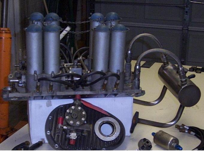

    While my wallet is slim, I think I can put away enough to put a Hilborn mechanical set up on the 302. I've been pricing it and think it's achievable, perhaps by April.

    I am thinking about injection. The moon tank will be mounted quite high, basically as high as I can get it behind the grill. The tank won't be pressurised but i'm hoping that the plumbing will at least be in line with the pump, if not higher.

    Are we talking a Stack or Hat injector?? The Hat injector is more universal as you can change Manifolds for different engine combos. The Hat-Manifold set up will make a bit more power then the stack. You have to be careful on the Stack injection as how you bolt it on and Milled heads, gasket , etc.. You can easily bind the shafts on stack injection that is one pc. A split set up for example like on Hemis is more forgiving to this. Again real condensed .

    Hi All, I am new here. I have a slightly off topic question, Can I use a Hilborn 150-0 or a 150-1 or an Enderle 80 pump with a 750 Alky carb on my Small block pulling tractor? I am now using a Black Holley electric pump.

    Thanks for the repy. I run it on alky now, the carb is a factory alky one from Holley.I have popet that retuns fuel back to the tank [kind of like a poor man injected]. I am using a Mallory SM IV so I only have battery for starting and to run the elec fuel pump, now at idle the fuel press is around 11psi drops a little during a run.I guess my question is:would an injection pump be better than the elec? I have 3 pumps to choose from Hilborn 150-0. 150-1 and an Enderle 80. I an using the green Brad Penn oil.

    I'm no expert. So here's a simpleton's thoughts: What are you looking to accomplish? I ask this because the 2 systems operate in quite different ways. For the carb - the airflow effectively controls the fuel mixture at a particular RPM (over simplified - I know). The pump only being a method of keeping the fuel bowl full which is why a constant pressure (or near constant pressure) is all that's required.
    Contrast that with a mechanical fuel injection where Fuel Pressure is what governs fuel mixture at any particular RPM - air flow controls nothing. The pump is "over pumping" and excess fuel is sent back to the tank to tailor your fuel curve. This is done (as you already know) with various poppets that you can set as various pressures to bleed off some pressure accordingly.
    So - I now would have to ***ume you're after more volume or am I confused?
    When you say your carb is a factory one - I ***ume you mean a factory ALCOHOL CARB???

    Hi, Yes the Carb was sold by Holley as an alky carb.The cl*** for our club is, N/A carb only. I was asking about an injector pump with a carb for more volume. I have a Bugcatcher on a tunnel ram that I can run in another club. but at the present I will run the carb.
