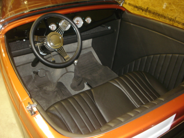

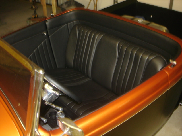

    Early Dodge caravan center.
    Fits perfect,back flip forward even gots cup holder (Hidden)
    Tried to upload pics but no go
    I'm 6'3" and plenty of room.

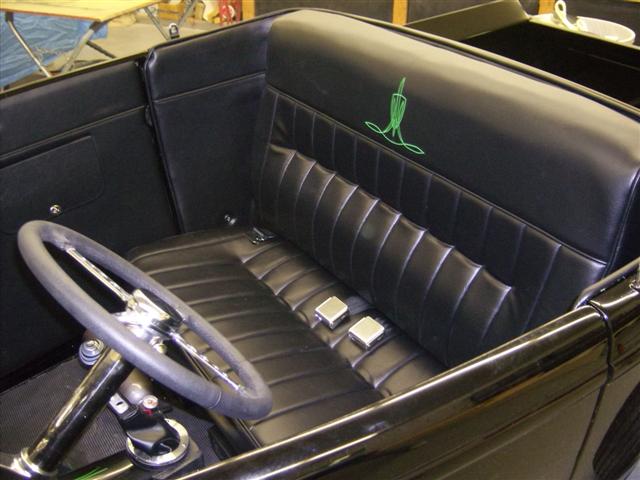

    Couldn't find what I wanted so I made one;

  13. da34guy
    Joined: Jun 13, 2006
    Posts: 3,708
    da34guy
    Gonna try the pics again 4 ya

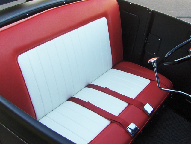

    Here's my Ford Windstar seat after upholstery

    Those look really nice. Wow is the way to describe them . Thanks for the info. Thanks all you guys for your input.
