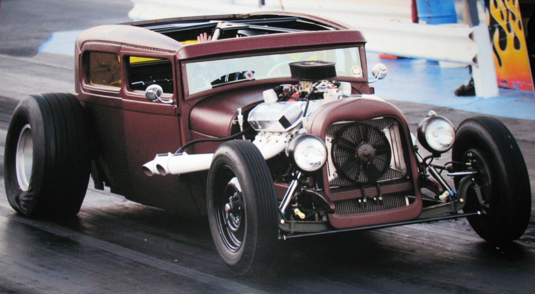

    I think you probably have a geometry issue. DW doesn't have any problem and he's still got a buggy spring in the rear with the nose way down.

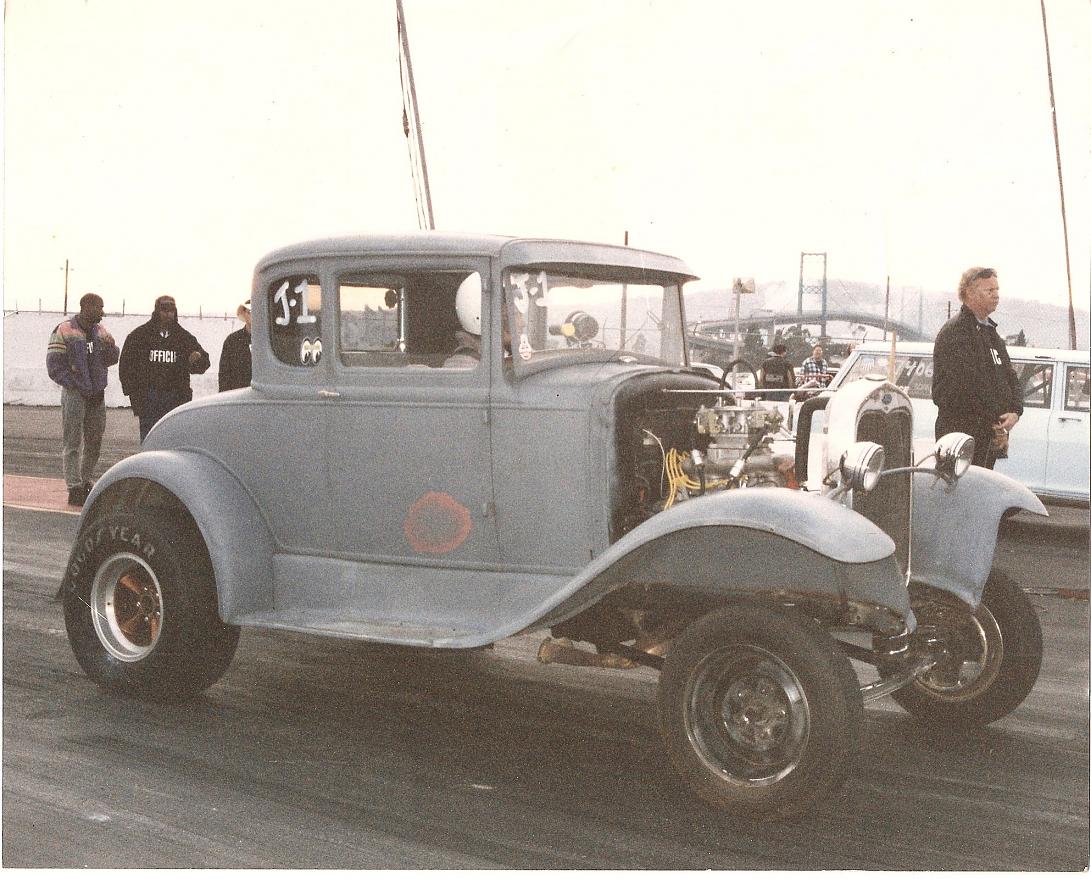

    His car looks as if it is working very well.. The rear tires are planted.. Thanks for all the suggestions, I need to get busy checkin it out, I will keep you guys posted as I go and try to post some pics..

    awesome picture, I wish I could get a tire up in the air.
