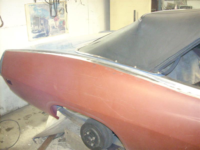

    I have a technic i use for a large panel butt weld or smaller to. I trim the panel 1/4 in larger than the hole you want to fill as if you were doing a lap weld. Tack your panel in various spots to hold. Using a cut of wheel with the finest blade you can find, say 1/32, and cut the 2 layers at the same time for about 1 ft. Like you where cutting a carpet seam. Reach underneath and pull back the cut strip and let it hang, just bend it back for a handle later. Same on top, just bend the little strip back. This will leave you a tiny crack to weld if any. I prefer a gap for expansion. Now weld that area about 1 inch and grind. Grinding immmediatly gets rid of some hot weld material. Heat is the enemy. Take your time welding slow and cool. Do not cool rapidly with air or wet rag. I shrinks and hardens the metal. Go to a cold spot at the other end and do the same thing. This will keep you busy so your not rushing the welds.
    So basicly what your doing here is holding the panel in the exact spot while you cut a bit, peel back the stips and weld some more.
    The advantage of a butt weld is you can dolly out your hi and lo's with out that stiff layered metal.I did this welding NOS 1/4's on my 70 Torino convert. It was near a 7 ft butt weld and had total control of the panel. Did the same with the tubs.
    Both ways work but the butt weld is just a hi end repair.
