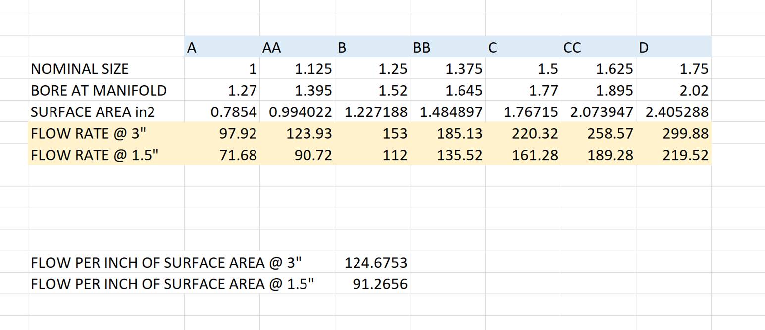

    The Winfield manifolds work great, just keep in mind that you will need the correct size carb to mount up. Manifolds were made in AA/B/BB sizes, and are stamped on the bottom near the casting number. watch for cracks near the port flanges. The 81 is about the same size as the Winfield AA, and a 97 about BB. Either size carb will fuel a modified flathead banger nicely.
    Winfield flow rates

  3. Wow that chart is super handy! Thanks for sharing. The current Winfield intake I have is a BB. The bolt hole spacing will be handy as hell!! Thanks
