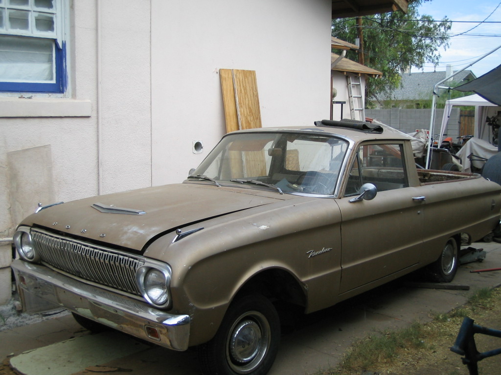

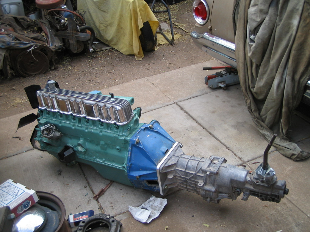

    As for how to go with yours, that I can't tell you. On mine I'm doing a 170 inch six, Weber 32/36 carb, adapted a T50 five speed so I can keep up with Phoenix traffic, keeping the four lugs but going to scarebird disc brakes, found a set of pretty rare Tru-Spoke 14"X6" four lug wires, 185/75-14" narrow white wall tires, and a little bit of lowering and some fun paint. That's it. I want to be able to throw my bikes in the back and keep up with and stop with traffic plugged with hondas and hyndias safely.
