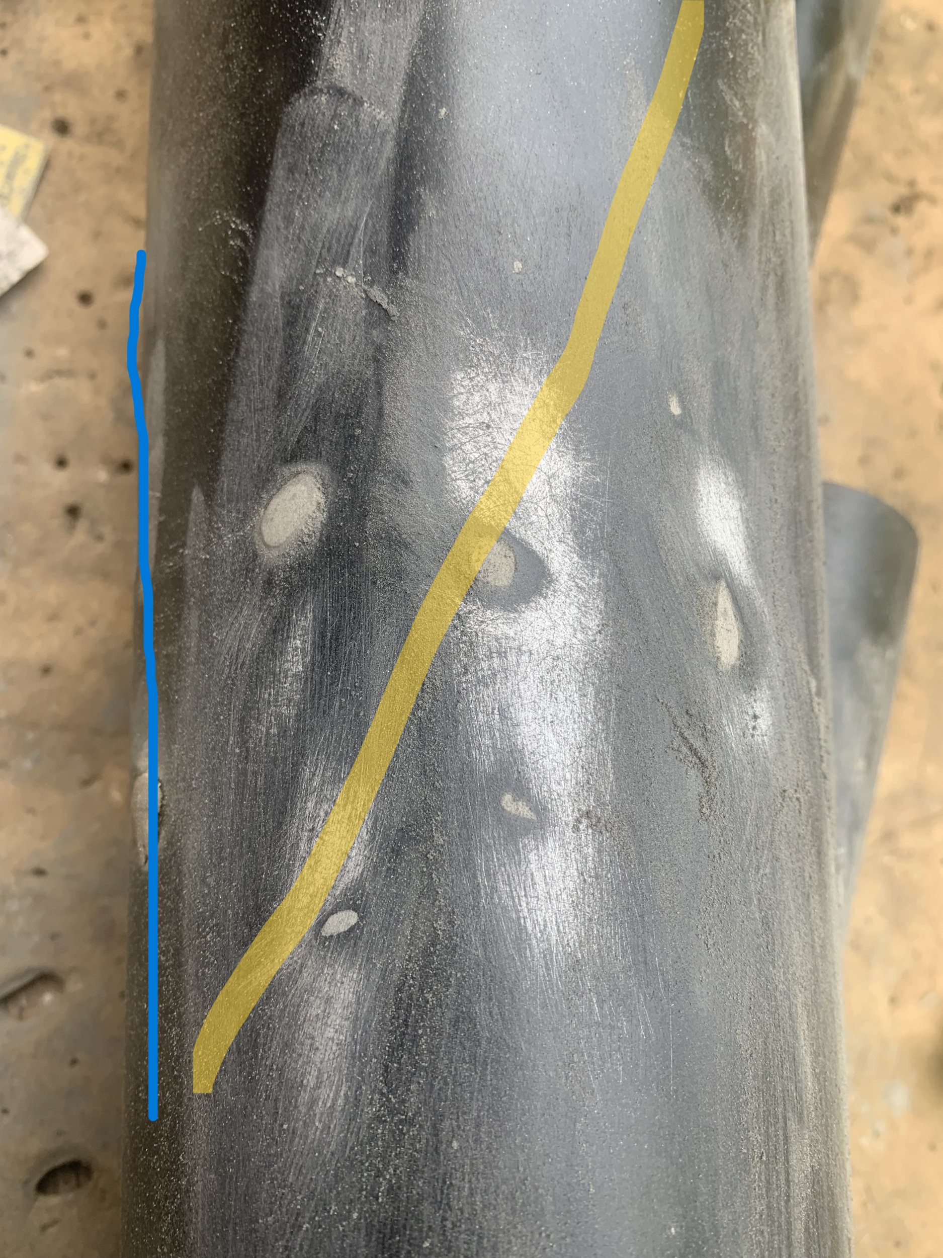

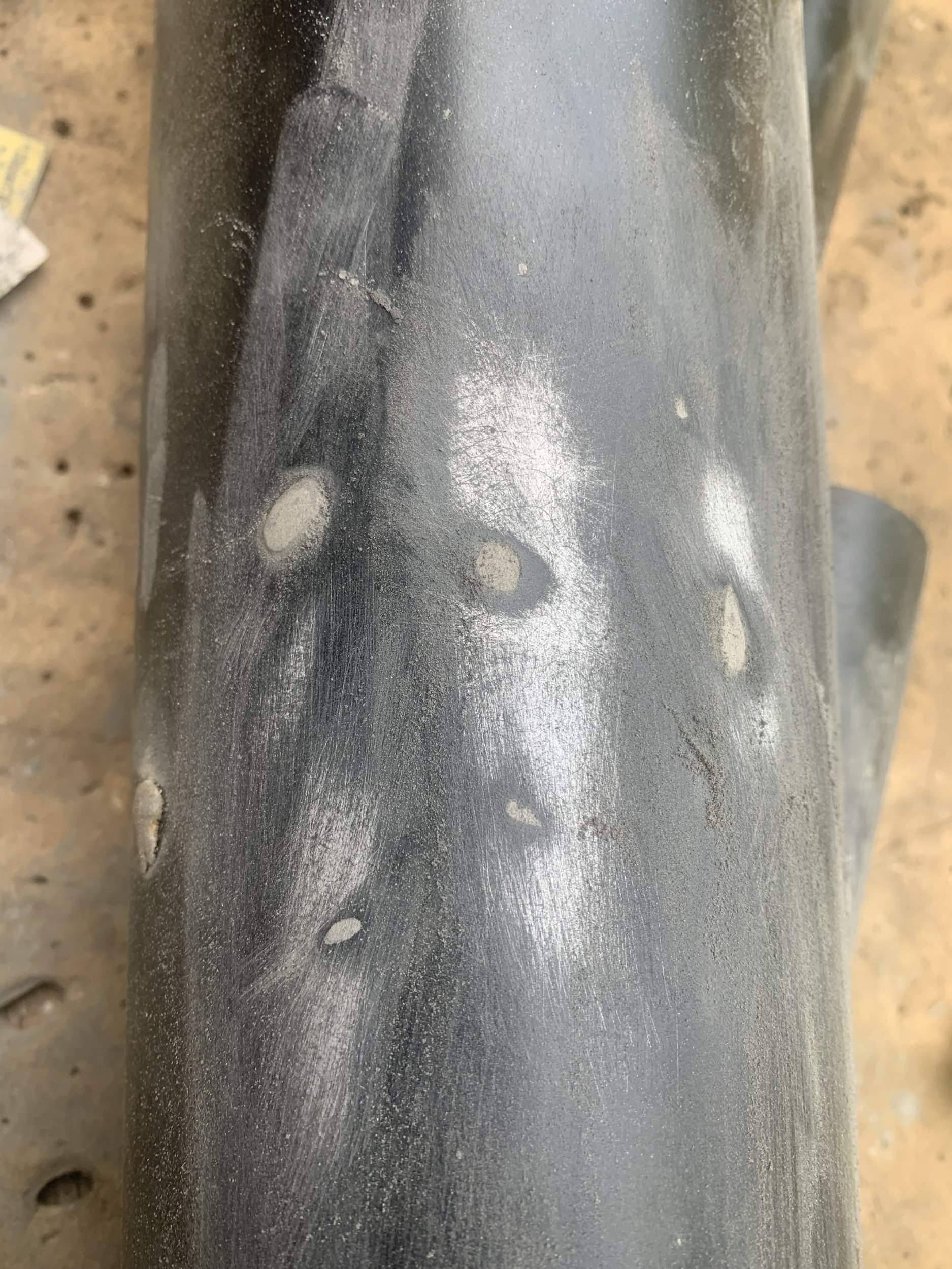

    A question I’ve been meaning to ask for a long time is why is it every time I’m sanding down high spots is that the first thing to disappear is the paint around the high spots?
    I’m no professional. Never used a proper paint gun, but have done plenty of rattle can stuff, and 100% of the time I’m always dealing with this issue. Is it my giant fingers, my technique, or is it just the way it is?
    Case in point. Was removing some excess epoxy from my exhaust collector, and I’ve reached bare metal (one top coat), before knocking down the epoxy high spots.

    Mostly just thats the way it goes. You either need to knock those high spots down before you continue (the better way) or build everything up around it.
    Hopefully you are sanding with a block of somesort and not just you hand. Your hand is not an accurate backing for sandpaper for trying to make things flat.

    it looks like that paper is too co****
    daylatedollarshort likes this.
  9. Over sanding is the biggest hurdle for beginners
    Under applying filler is another.
    some high spots can be due to the nature of the dent. Like tossing a rock in mud, you get a ridge around the low area.
    To cure that, tap or pull the low up, tap the high around the edge down.
    your “high” areas look to be the result of both under applying filler and over sanding.
    As the metal around the dent begins to appear near the dent, that indicates that that area is either a high spot or you are done sanding in that area.
    if you reapply filler to those spots, sand with the contour of the part. If the surrounding metal starts to show up and the filler indicates it’s still low, stop sanding. Scuff up the low spot and apply more filler.
    If when using your hand to check for level and the surrounding exposed metal feels high, tap it down than apply additional filler.
    Apply enough to the area that allows the filler to feather into the metal. In other words, wipe an area slightly larger than the dent.

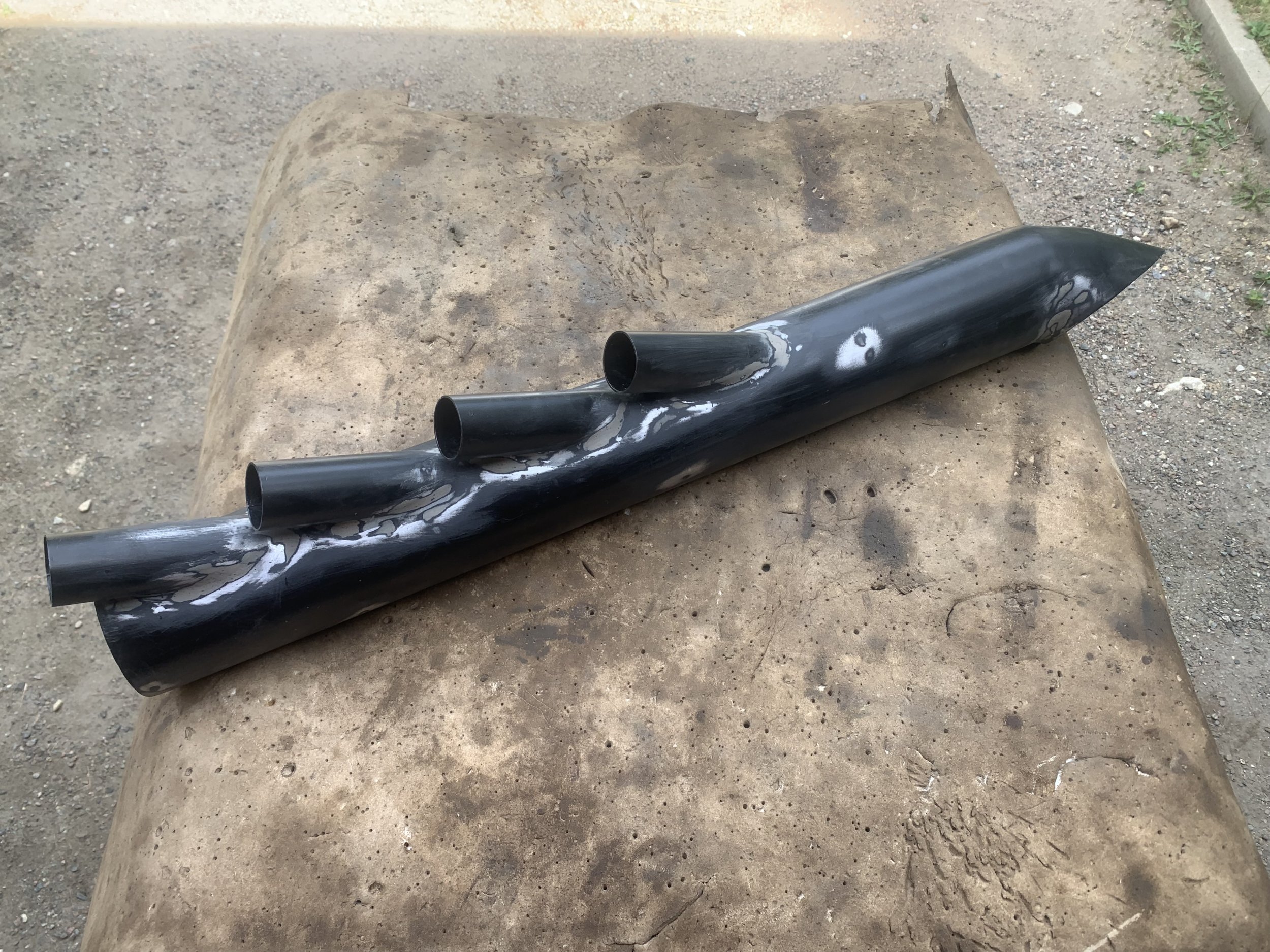

    The example in the pic I chose, was probably not the best to illustrate my question. To be clear, it’s a 4” dia exhaust collector that I’ve been working on. I applied some hi-temp epoxy around my welds that were contoured to fill in some imperfections. The spots in the pic were various small nicks, dents, and scratches where I applied the epoxy. Used 80, 120, and 220 grit.
    In this case, on something that is round what would you suggest? Also, had the same issue sanding the epoxy around the welds for the inlet tubes. In those areas, there is no space to use any tool. So, basically small bits of sand paper rolled up, and using it almost like a toothbrush. First pic after first top coat, and another application of the epoxy. You can see all the bare metal surrounding the areas where I applied the epoxy. Second pic, finish sanding the epoxy before first top coat. Used VHT caliper paint.

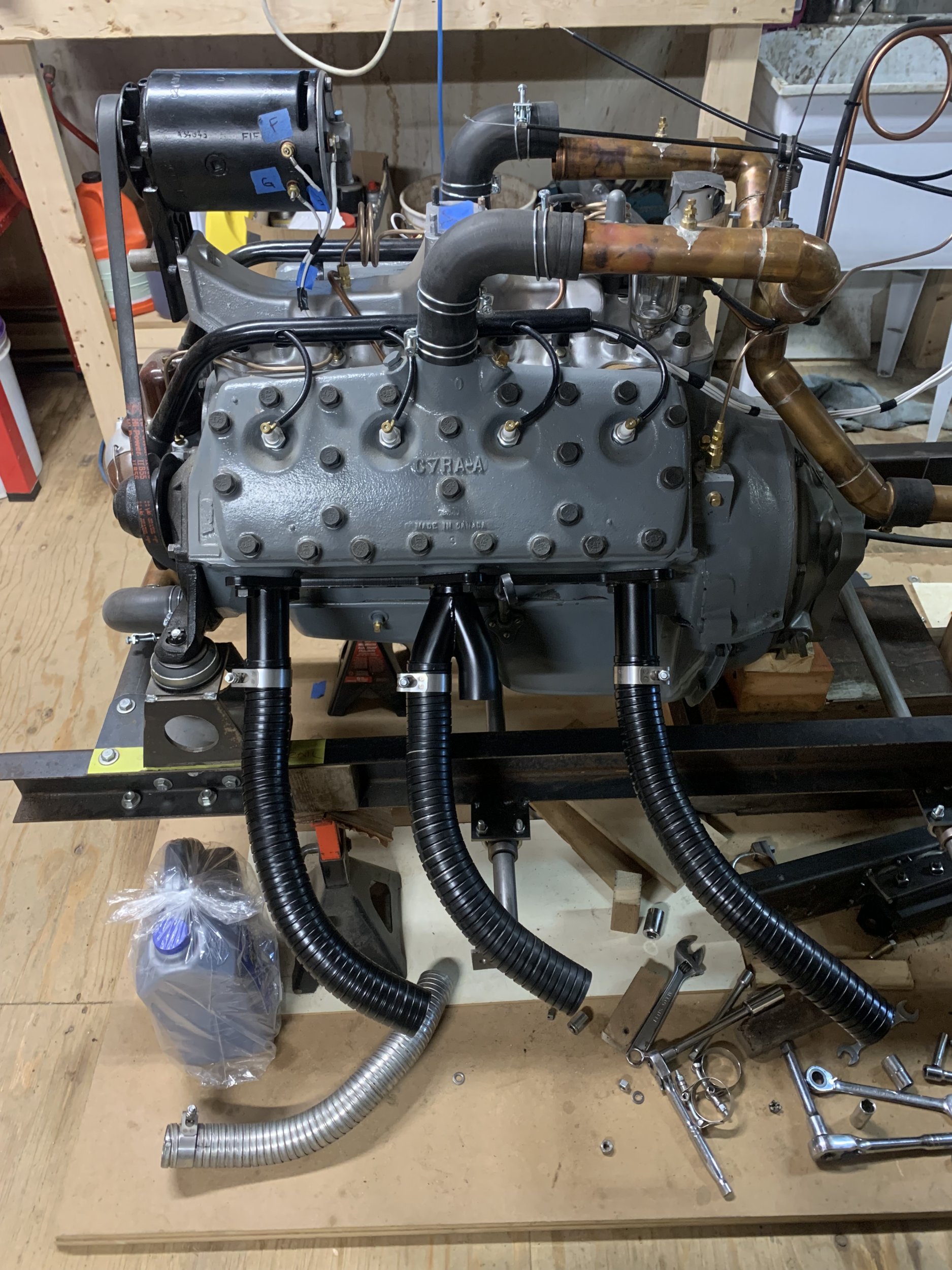

    Haha! We’ll see. There is about an 18” flex tube between the manifold on the engine and the inlet to the collector. I think the max temp of the epoxy was around 500F. If it falls off, I’ll be disappointed, but overall not a big deal. Just my ADHD kicking in overtime. lol!
