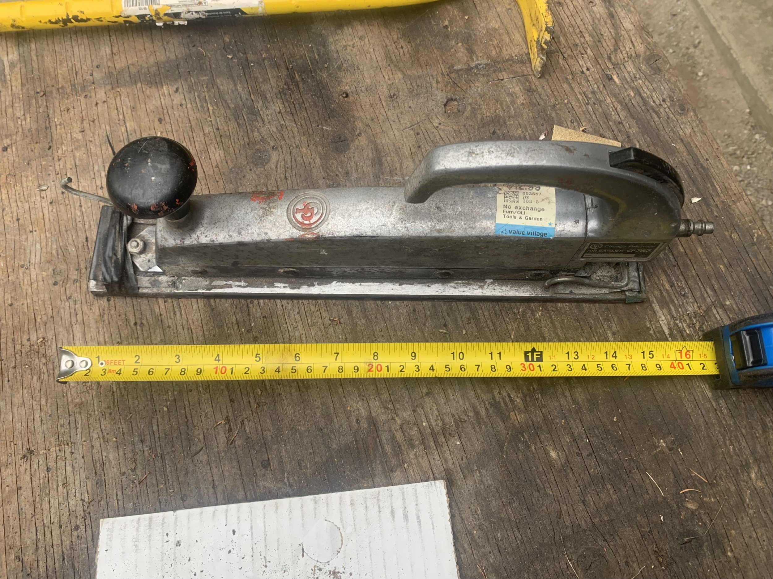

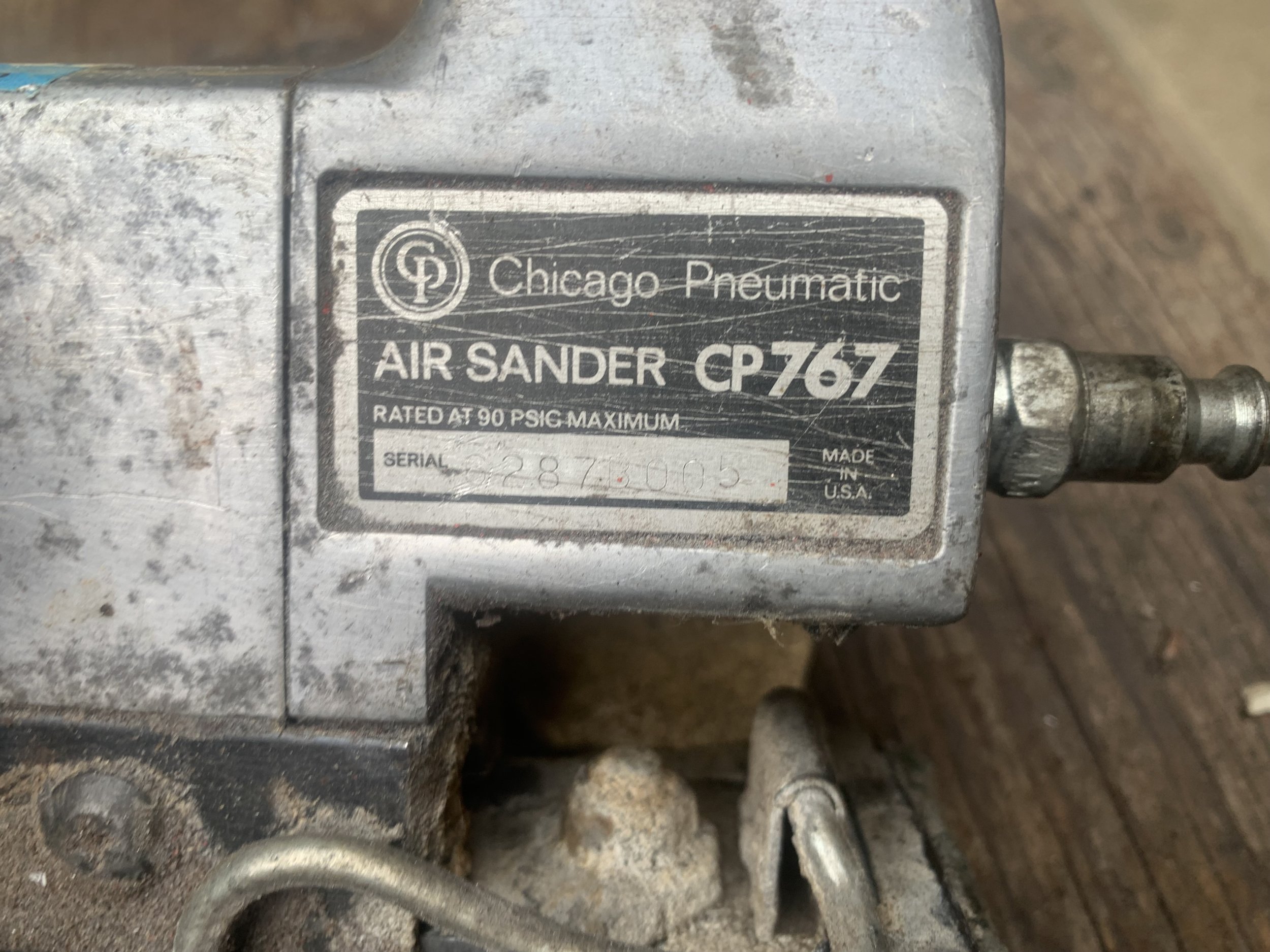

    Found the pneumatic body file. Still works. Is this thing still used, and if so, can you get pre-cut paper for it? I have a bunch of rust repair to do on the rockers of my OT project.

  20. alchemy
    Joined: Sep 27, 2002
    Posts: 22,680
    alchemy
    That air file is only useful if you already know how to do it by hand. Very easy to go too far in a hurry. Same thing with a DA.
    The key isn’t just using long paper on a block, it’s the long strokes that come with it. Not just letting the block cut into the 12 inch section, but gently covering the whole quarter panel evenly.
    I might consider using the jitterbug (with some 36 grit) to cut the sticky crust off the top of the filler, but do it all by hand after that.

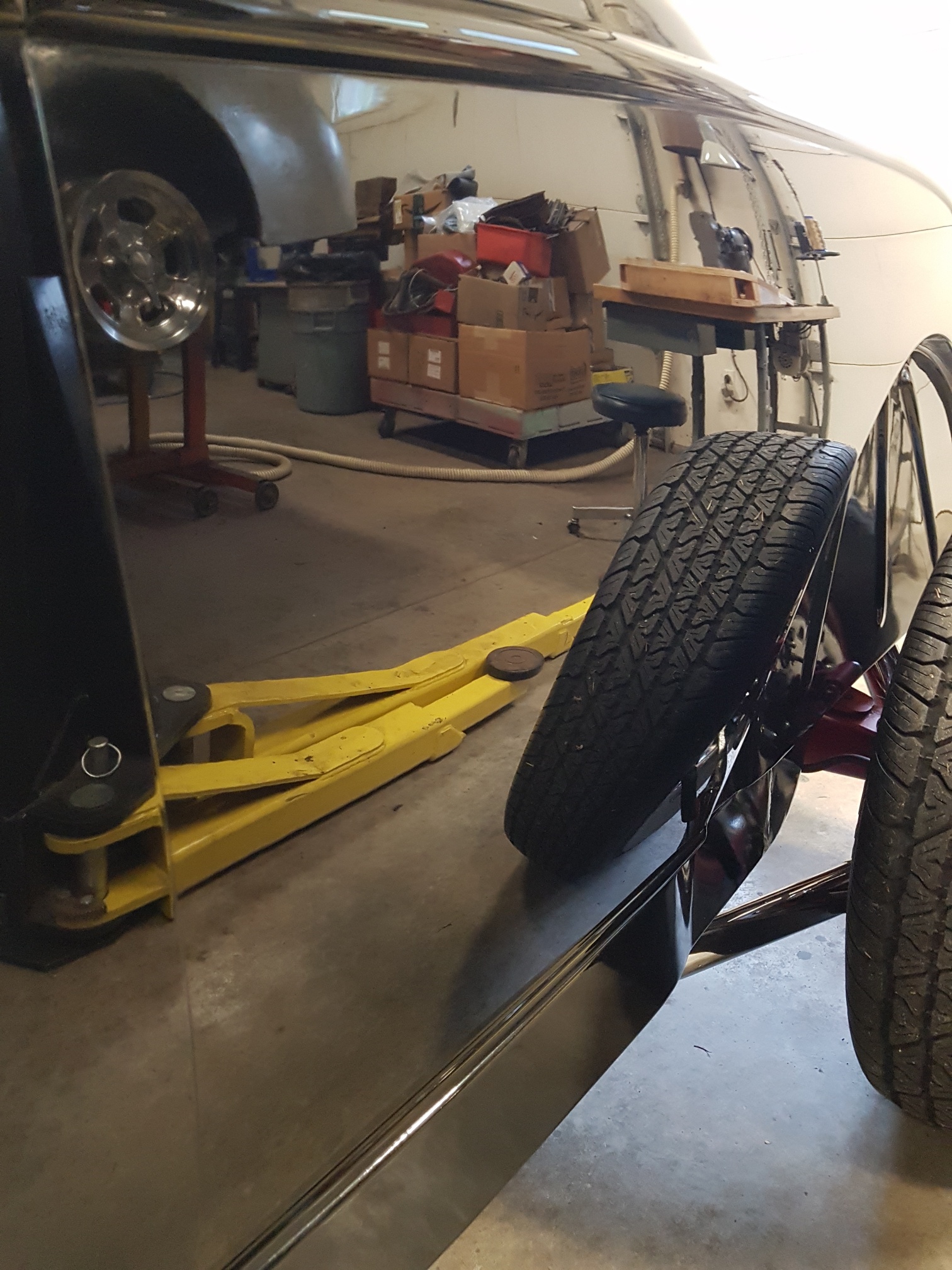

  21. As has been said...most work is done slowly and methodically using whatever combination of blocks and filler needed to get the results you're hoping to achieve. Others have mentioned the stroke patterns. It takes way longer than you hope or expect...there are no shortcuts. But, when you get it right...you can turn a panel/filler that looks like this:
    Into something that looks like this (this is the before/during and after on the same panel):
    It's very rewarding...and worth the effort...but as said, also very time consuming. If you find yourself saying "that's good enough", don't kid yourself, it's not, and the shortcoming will definitely show in the final results. I'm currently at the stage of finding the perfectly straight panels on my '38 cabriolet build, and it's taking longer than I'd hoped...but it's just the process, and I too need to remind myself of that often.
    Good luck...and, while some are ok with spending the tens (and in some cases hundreds) of thousands of dollars necessary to achieve these results, I'm not that guy/person. I also find it extremely rewarding when people ask who did your body and paint, to be able to respond "I did, in my home garage"...that's when the time and effort it took to achieve the result melts away, and turns to pride. Again, good luck and enjoy the process.

    I buy mine on amazon, any grit you want, continuous and adhesive. Or get the non adhesive. I love my air board, not perfect for all applications...like it's owner.

    Amazing result! Generally speaking, I’m pretty impatient, but at the same time seem to always want or expect “perfection” in whatever I do. I plan to do the metal forming from scratch for the body on my speedster. Met a local metal banger who was 70, but was willing to teach, so will see if I can take him up on his offer. I love watching guys like Karl from Make it Kustom, and Jordan from Bennett’s Custom do metal forming on their projects.

  27. I’m not the biggest air file fan
    If the metal is right, it doesn’t take much to sand
