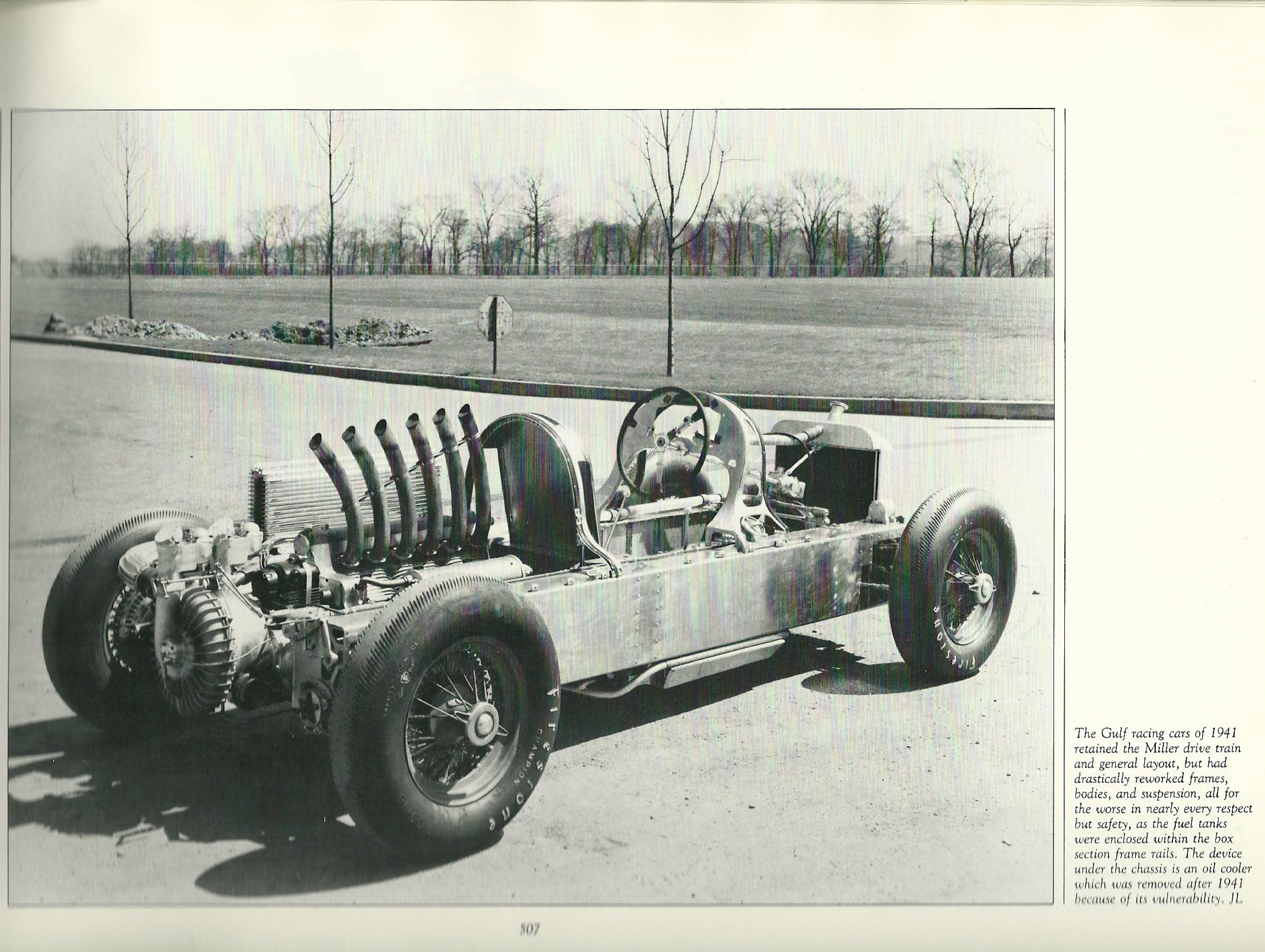

    Here's a picture of the Miller/Gulf Indy racecar for 1941, while the frame rails are larger than you'd use they do have rivets and modern alloys are better. With aluminum you have to spread the load out to minimize flexing and failure. And mig welding doesn't anneal the aluminum like tig does. A friend of mine has been repairing dragster engine blocks for years using mig with good results. Build a scale model and stack bricks on it, you'll soon get the ideal shape. Have fun!

    If it were my project, I'd go the semi-monocoque route, where you build a load bearing frame/floorpan ***embly that is pretty much one piece, and then hang the body on top of that flopper style (no additional floorpan).
    Just be aware that all aluminum structures will fatigue in service, and all of them will crack eventually, so regular inspection will be key.
    Basically, you'll have to treat it like a low flying air frame, and give it an annual inspection . . . well, annually.
    If you stay on top of repairing the fatigue damage when it starts to show up, you can keep the ch***is in service for quite a long time.
    Light air craft routinely stay in service for 50 yrs or more. I see no reason why a similarly constructed hotrod ch***is could not have a similar life span if properly cared for.
    The proper care and maintenance will be the key though.
    Well, that, and proper joint and ***embly design to start with.
    Think "distributed load".
    You want to spread the loads out as widely as you can. Concentrated stress breeds cracks, especially in aluminum.
