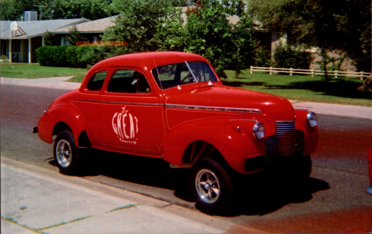

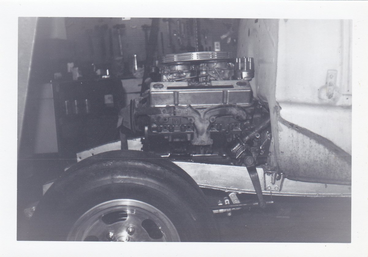

    Sleep easy, friends. I have done SBC swaps into '37's, '39's, 1940, and '46's.
    Here is a picture of my yellow '37 sedan I did, as well as
    the early stages of my '40 Chevy. Later on, I put 6" C-Channel between the frame and suspension
    to raise it up, without affecting the geometry. Basically, this same front end design was used on all
    cars up to '54, and even on the C1 Corvettes up to 1962!! Never had an issue with the suspension or ride.
    41 coupe and jimmy six like this.
