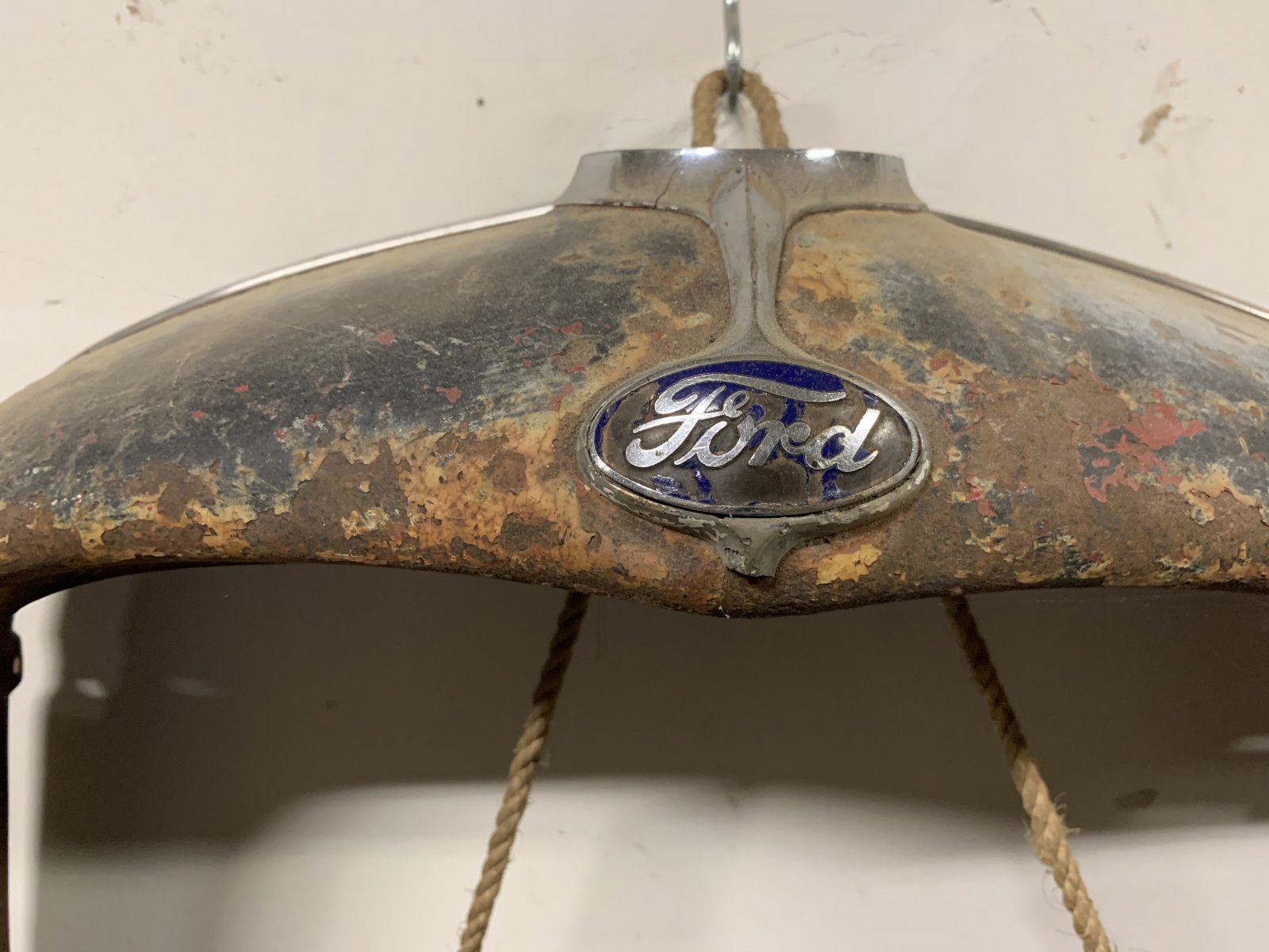

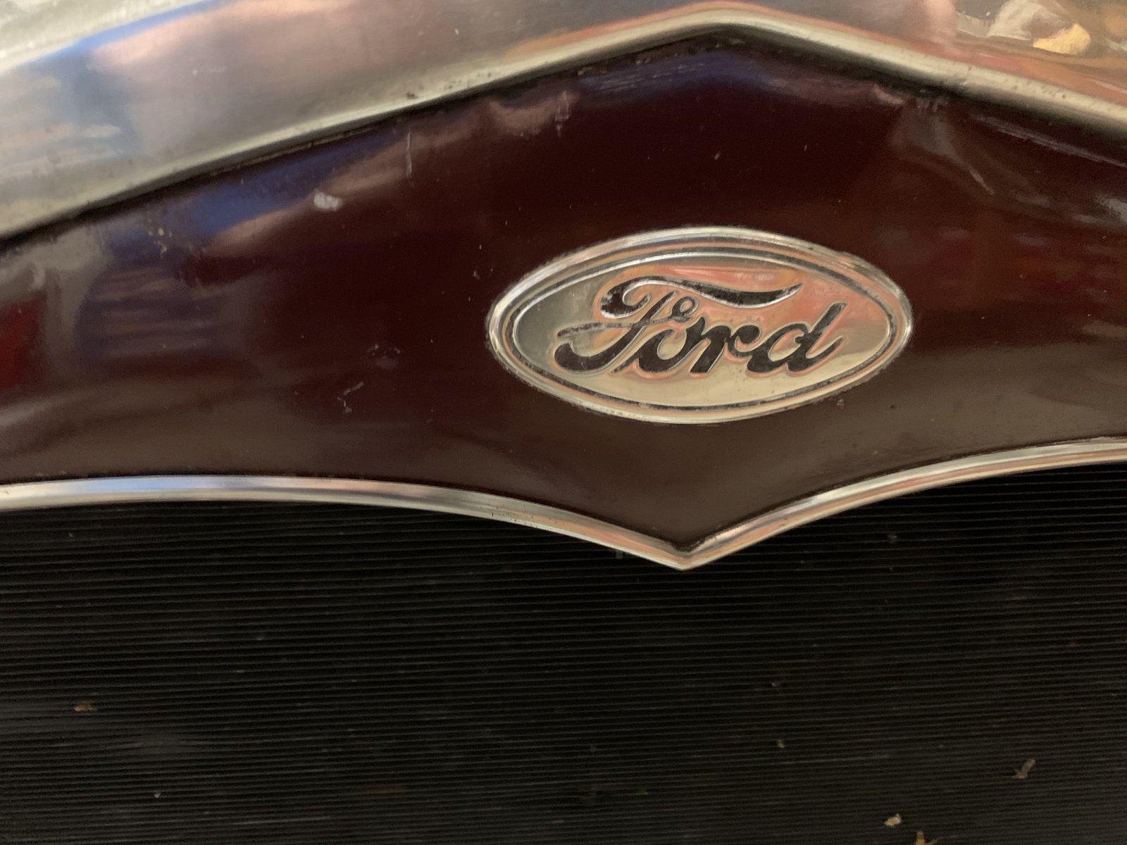

    Here’s a 31 emblem, same would be used on the car and the painted commercial shell. Here’s a 32. I have a 30 shell but it’s up high on the wall so can’t get a good photo right now. That would have the blue porcelain background on US built vehicles.
