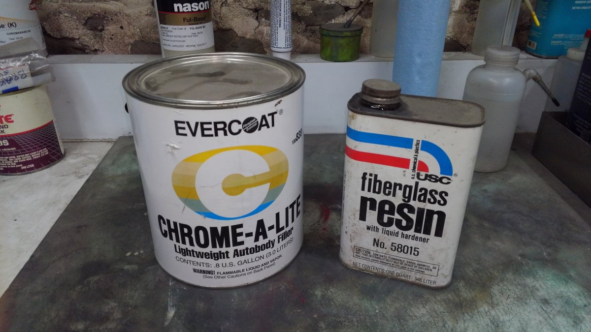

    A different spin, $20.00 an change a gallon, an a shot of resin, will have the same results, an actually I prefer it over the "enriched" versions mentioned, I have seen adhesion issues from time/time with the rage's, An y KIMG1858.JPG a Any filler can, but working in a vette restoration shop on/off 16 yrs, I've skim' coated hundreds of car... What worked for me, An I even used it on my 356, (painted black) Another huge factor no matter what you use drag the filler on the board a couple times to eliminate as many air bubbles as possible! Good luck!
