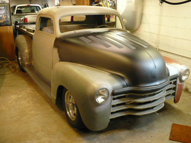

    Thanks for the info and the PM's. I got pictures of the truck last night and the body and fenders are mounted on the frame. I need to take the a drive and look it over. Probably need to determine what wheels I might want to run to see if the setup would work. Keep any other info coming.
    I guess the next question is what is a good width for the rear end? This truck has a camaro rearend 3.73 gears but not sure of the year. Guessing it came off the 80 as well.
    I am a little torn between going with the narrower steel wheels for the old school look or wider 18/20 combo.
    Thanks for any help or pictures you can post with details of tire and wheels sizes.
