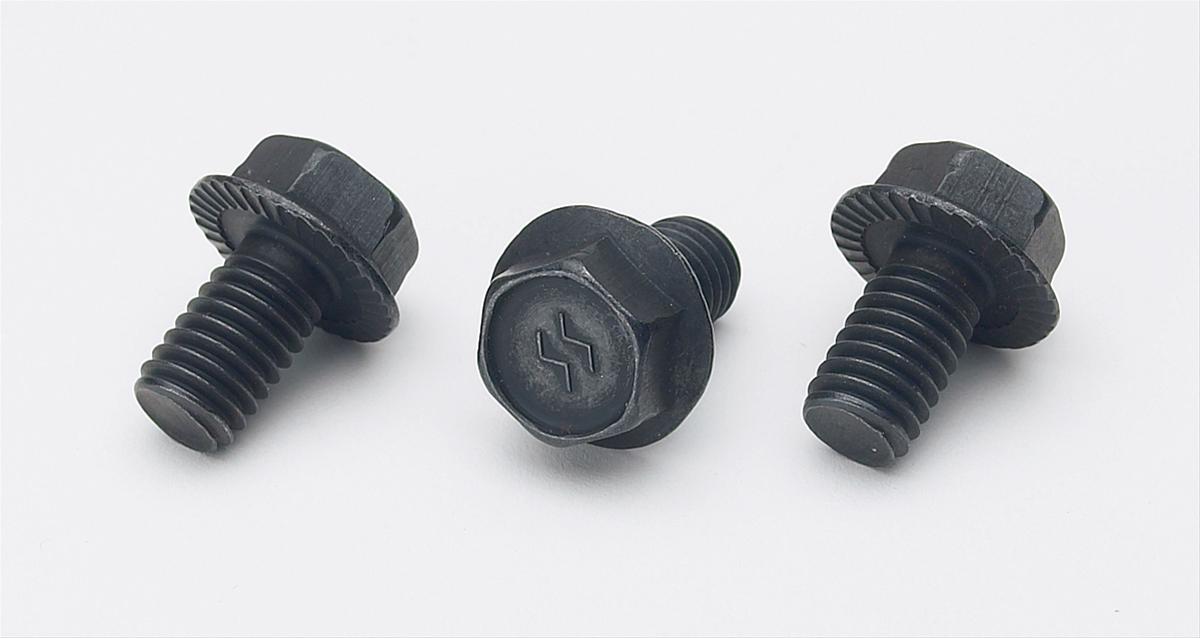

your not supposed to use the bolts as driving stud, but clamp the converter tight to the flexplate with a wide head bolt or a bolt with a built in flange . (http://static.summitracing.com/global/images/prod/xlarge/mor-38765_w_xl.jpg) , and never use flat or lock washers either they can throw the balance off ( spring washers specially if one breaks ) blue locking compound is prefered , a couple of .oz off far out on the fly wheel can cause problems ( think what a couple of oz does to a car wheel and its the same thing . )
