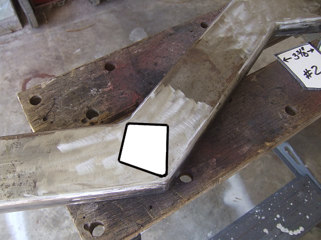

    Just finished welding my new rear frame rails. I want to weld Gussets on those joints. Is there any rule as to how far out from the origional weld the Gusset should be? I have a few paper models laid out on the rail. What do you think? [​IMG][​IMG][​IMG]

    i like number 1

    I did #1 on the S&W junk I welded up....
    A suggestion... Don't make any sharp corner welds. #1 w/ the corners rounded will reduce stress points.

    Adding a gusset in the place you are showing has a pretty minimal affect on the strength of the frame rail. The very best place to increase the strength of the rail in bending, which is the biggest loading it will see, is to add a strap along the bottom of the joint, make it extend 3-4 inches on each side of the joint, radius or taper the ends. In bending the top flange is in compression load, the lower flange is in tension and the sides are in shear. With the bottom flange in tension this makes your weld at the joint on the bottom in tension and adding the strap to the bottom reinforces that weld.

    I prefer fishmouth plates (no welds straight across main rail) sorta like this:)

    What you have laid out are not gussets, those are fish plates. The frame looks to fabbed from 2X3 or 2X4 tubing? A box section is by definition all ready gusseted. Seems to me that you are trying to reinforce the welds, properly done the joints are as strong as as the materiel.
    I vote for none at all. If you keep adding welded on patches you will only create stress. A plate welded to the side of the rail contributes nothing.

    I agree with Chubby, if it is indeed tubing, if wanted the plates should have been rosette welded on the inside of the tube.:)

    But now that you are where you are now, I'd drill some 1/2" holes in the plates you plan to use. Weld them around the edges, and rosette weld the holes full.

    you need fishplates. #1 with rounded corners would be fine. I make my fishplates oval shaped so the stress is never square with the weld.
    the load stresses on the frame rails are such that it stresses the welds in the weakest direction. The fishplates add more welded area and with rounded corners will eliminate any stress risers making your frame a lot stronger at the bend than it it is at the straight sections.

    One thing that may hepl is that I cut out pie pieces rather than doing full cuts, so I have uncut metal on both outside bends. This is all great info and I appreciate all comments. Gives me alot to consider. [​IMG]

    If you are concerned about the welds, I would use the fish mouth plates recomemed by "51 Merc" but I would make them a little longer (1 to 2 " longer) and plug weld them with 6, 3/8" holes onto the inside of the tube.
    Leave about a 3/32" gap and then butt weld at a higher heat than you would use if there were no back up plates.
    Then grind all you wish, you will still have a 100% weld.

    What others have said, I've never heard of them called fishplates before, but if you're using flat plate on the outside then that is what you want - no sharp corners, and a plug weld or rosette on each side of the joint you're covering. We use patches like these for reinforcing butt welds on rail car repairs where I work, albeit a bit bigger in scale.
    If you do it again, the better solution would be to leave a gap in your butt joint, about the same size as your material thickness, and put a solid backing strip behind it, even better if you bevel the edges of your butt joint about 45 degrees or so. I'm not exactly sure of the strength difference but it would look a little cleaner anyway. But using a fishplate in this case is fine too.

    My opinion ( Which may be worth less) is that cutting the square tube in this way actually leaves that uncut part weaker due to the bending of it to shape.
    A weld most likely would be stronger, due to the weakening caused by the bending.
    If I did a plate, no matter what type, I would leave the fillets of the weld, they add strength and are perfectly acceptable to look at. The act of removing the weld fillets for visual appeal would render them a lot less effective.
    I am tending towards the fish mouth because it changes the stress pattern on the tube. Had you left the dimes, I would have maybe said none required, but now you cut some strength off, and we can't see by looking at the dimes how good you are or not at welding, so now I would fish mouth them per Chubby and Jay.

    I ground off the welds in anticipation of adding the FishMouths/Gussets. I figured it needed to be flat. Didnt really figure that there would be so many Pros and Cons. Live and Learn, Just love working on the car annd I want it to be safe !

    If not, forget all the add on stuff.
    If you can do certifiable welding, there is no reason for it.
    Don't grind off the welds.
    For what it is worth, ground off welds will not pass tech in most racing venues.
    In some cases on cages, open corner gussets are required.

    Must be pretty thick stock for 130 on 6011, if you root passed it, it's a shame you ground it. Was most likely very strong. I'd fish plate it if it was mine and leave the welds showing, just buff them to remove the slag. That's my opinion. See what Jay and Chubby think.

    In the aircraft industry, most often than not, the welds are stronger than the material being welded (after being tested). You should be able to accomplish the same thing if you are doing a proper weld, set up, etc. Then, as Chubby said, no additional plates will be required.

    I say fishplate em, then you dont have to worry about if you should fishplate it or not.
    they arent going to hurt anything and if your not sure 100% in your welder or welding skills, it may save your ass.

    You want the fishplates to be diamond (or fish) shaped. A sudden transition with a vertical weld creates a stress point. The reinforced part bends less, making the unreinforced part next to it flex more. A gradual taper transfers the bending stress more smoothly.
