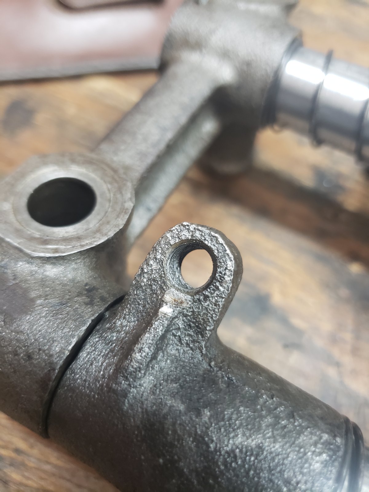

    I picked up these Gotha rockers a few years ago, but havent used them yet. There doesn't seem to be much info about these rockers. 18402.jpeg
  6. dwollam
    Joined: Oct 22, 2012
    Posts: 2,833
    dwollam
    They look like stock Chrysler adjustables to me.
    Dave
