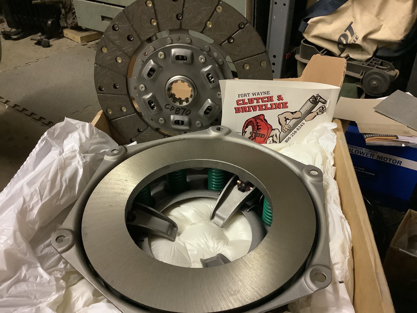

    This may save you some looking, and some $$$ if you have a local clutch rebuilder.: Ft Wayne clutch is expensive and gets $90 core charge.
    Stock Chevy flywheel drilled for Borg and Beck.
    Speedway pilot bushing.
    Borg and Beck #1310 pressure plate.
    Stock Ford clutch disc.
    Early Chevy nose style 3 bolt starter.
    Adapters are the same for SBC/Early Ford.

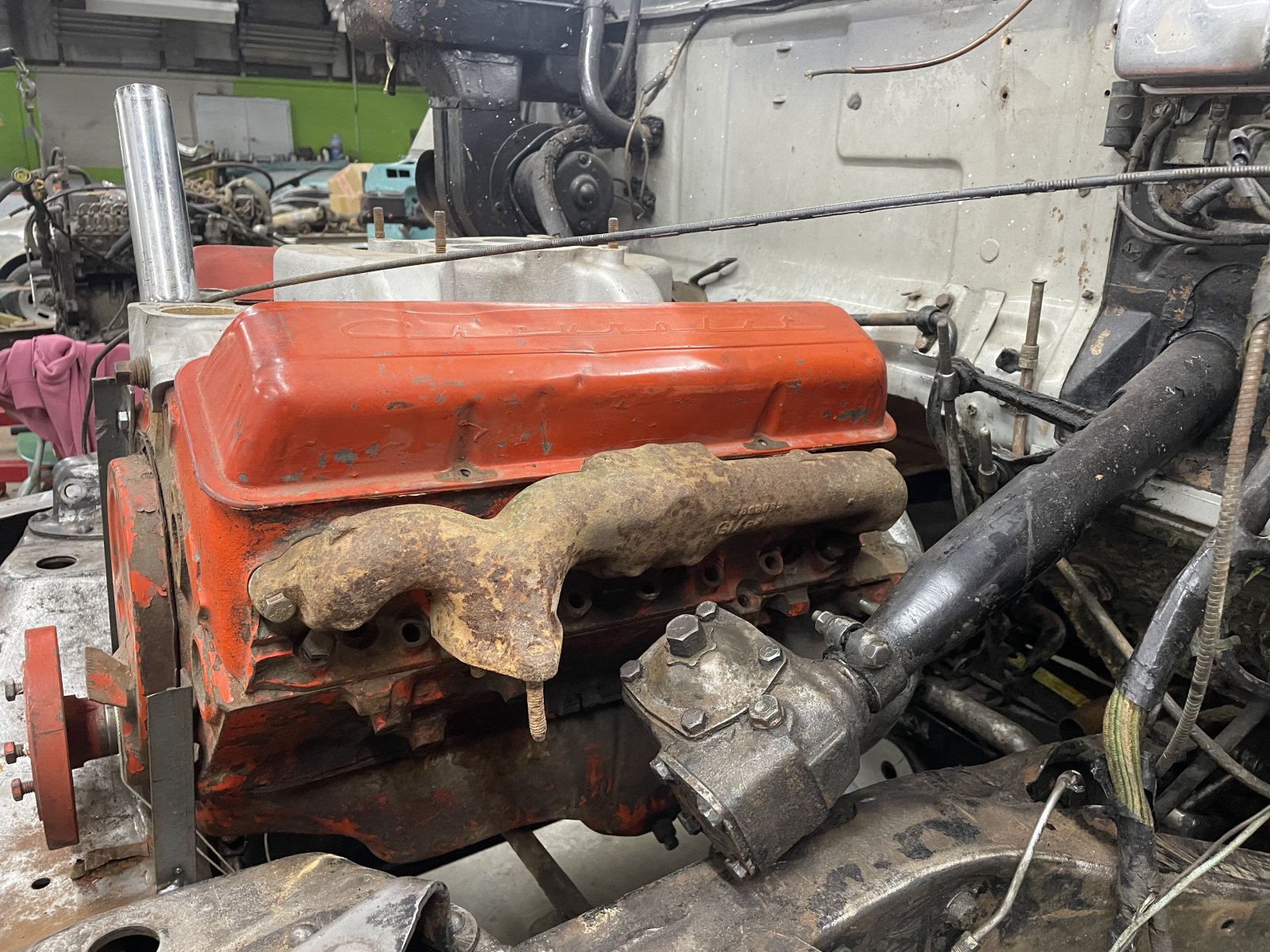

  12. 283 with an old speed gems adapter.
    There’s usually several in the hamb cl***ified for sale.
    it’s crazy how similar the sbc and flatty oil pans were.
    Had steering box issues with the rams horn manifolds so I found some 55/56 Chevy manifolds
    51 merc ch***is.
