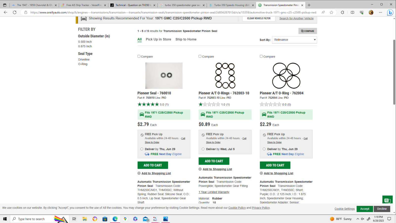

    This the O ring and seal you are looking for. This Screenshot (1799).png Screenshot (1800).png just for show and tell as you should be able to get them at or through a local parts house. They should be about 6 bucks at the local O'Reilly's or other local parts house .
