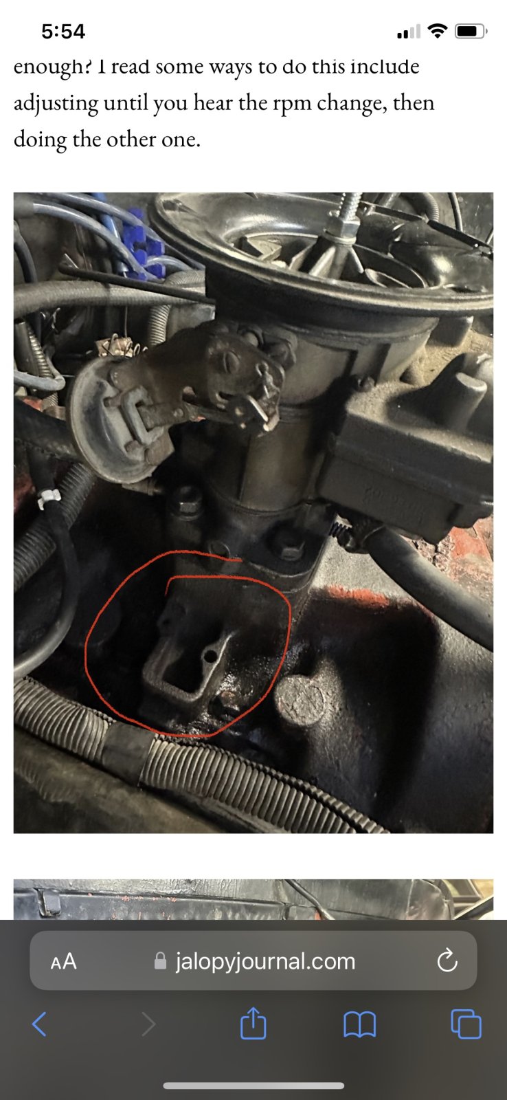

    I notice when starting up the truck if its been in my garage untouched for a while I have to feather the pedal for a good minute to two minutes. I looked at the choke setup and only see the vacuum part in the back but nothing on the side like I've seen in other photos online. Has anyone else seen this as well? It looks like the choke*****erfly plate is in the open position and stays there but can't tell if someone modified to keep it like that. Would I even be able to add the remaining choke pieces (heat or electric) with my carb? I don't feel like adding manual choke, I'm fine feathering the pedal at that point.

    Divorced choke is missing; not sure how it even runs???
    Look at the picture. There is a almost rectangular hole in the intake on the side of the carburetor with the the choke pull off. The should be a small cannister containing a spring, with a rod then connecting the spring to the choke on the carburetor.

    Thanks I see that now! The rectangular area is recessed not an open hole. Is it just a matter of finding a divorced choke for the 2 barrel Rochester on eBay and installing it and hoping the rest of the carb works with it? I did notice the choke*****erfly stuck in the open position so I guess I would need to see why that is. I’m not surprised with the crazy things the previous owner did to this truck that I had to fix.
    As far as your comment on being surprised it runs at all… it seems totally fine after it warms up but I have to feather the pedal quite a bit for the first couple of minutes usually…. If the engine was warmed up enough the choke shouldn’t matter anymore for the Rochester carbs?

    If the choke*****erfly is wired open, then yes, it will run normally after warm-up.
    There are literally tons of DIFFERENT divorced chokes. You probably do not need to be concerned about manual transmission/automatic transmission or A.C./no A.C.; but you do need to locate a choke for your year of intake manifold. And make sure when you order that you are getting the linkage rod along with the choke. Many replacement divorced chokes to NOT include the linkage rod, and yours is missing.
    There are some folks that just plain do without the choke wiring it open, but as you mentioned, it can require some TLC prior to warm-up.

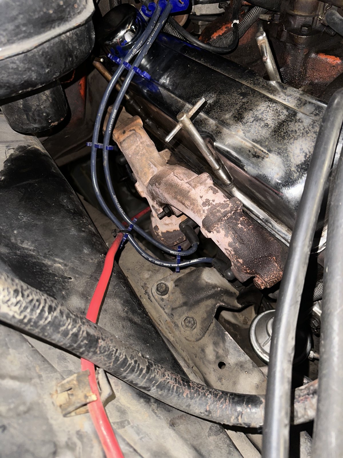

    To get the divorced choke to warm up properly, there is usually a heat riser in the right exhaust manifold that opens up after hot, to direct hot exhaust gasses across the intake manifold or it will take forever for the choke to fully open.
    I did see one setup just recently on a 71 impala 350 2bbl carb, that was factory untouched. Instead of a heat riser in the right exhaust manifold, there was a sleeve in the right exhaust pipe at the manifold, that has a reduced ID. Maybe to direct some exhaust gasses across the manifold all the time?

    Thanks I don’t see anything like that on the ram horn exhaust manifolds. Maybe they don’t go with the original engine and maybe since it took forever to open that’s why the previous owner removed the divorced choke and made the choke*****erfly so it’s wired open (I’m****uming it’s wired open can’t tell if it is or if it’s just stuck open)

    Without some means to direct hot exhaust gasses across the manifold when the engine is cold, the choke most likely will take way longer to fully open for your liking.
    We see this happen when headers are installed on an engine that still has factory carb and divorced choke setup.
    Probably the best way to get a choke that works is to convert it to an electric choke.

    Do they know what this area of the intake is for? F7806E9B-08B2-48F5-947F-3AD412F5752A.jpeg
