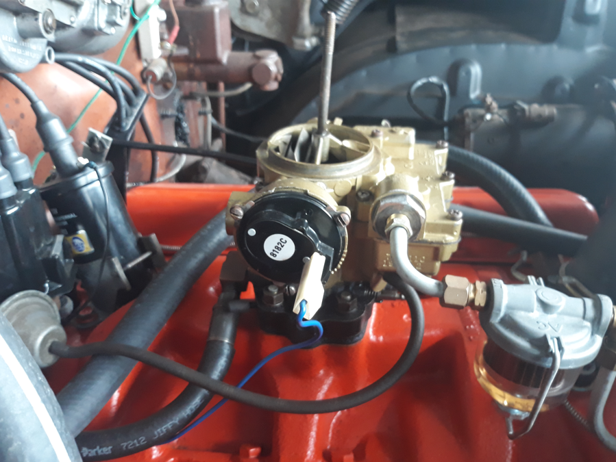

    No..... I have a 2GC on my 57 Chevy which we simply added an electric choke conversion.
    Mine was a 2GC which had that awful heat tube [this bolted to the side]
    Your Carb is a 2G with a divorced choke so you can use this kit.
    https://quadrajetparts.com/electronic-choke-conversion-1963-2bbl-rochester-p-2635.html
    There are plenty of ways to wire them.
    You can run a wire direct from the fuse box [they only draw 3-5a]
    Some people use a relay via the Alternator idiot light wire.
    In my case I used a relay from the fuse box that grounds via the oil pressure light to activate it.
    This powers an electric priming fuel pump and soon as the engine starts and gets oil pressure it switches off the pump and diverts 12v to the electric choke.
    ^^^^ the electric choke doesn't cycle unless there is oil pressure.
    It is really simple to wire if you're interested [and No fuel pump switch/button is needed]
    edit: Later if you want to convert it to 4 barrel you can use an Edelbrock #1406 Carb with an electric choke.

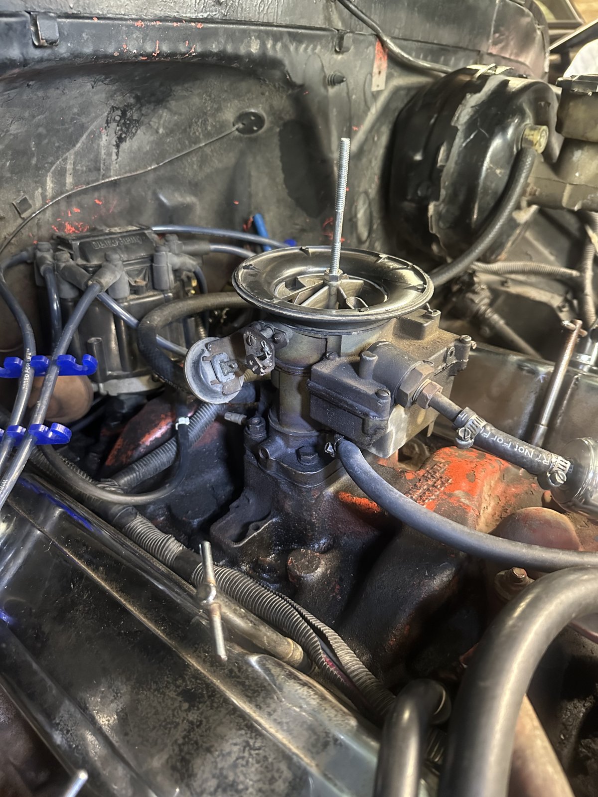

    Awesome thanks! I was basically thinking the only thing that would work is an electric choke that is divorced... looks like this one would work! I should be able to figure out the wiring.
    I'm going to adjust the idle mixture screws and see if the choke is even still necessary. Maybe I'm needing to feather the pedal because the mixture screws are not set correctly.

    The wiring for an electric choke is a wire that is on when the ignition is on.
    Resist the urge to use the coil wire. This really should be a seperate circuit.
    Most often, I will use a relay, and a thermal breaker (self resetting).
    justpassinthru likes this.

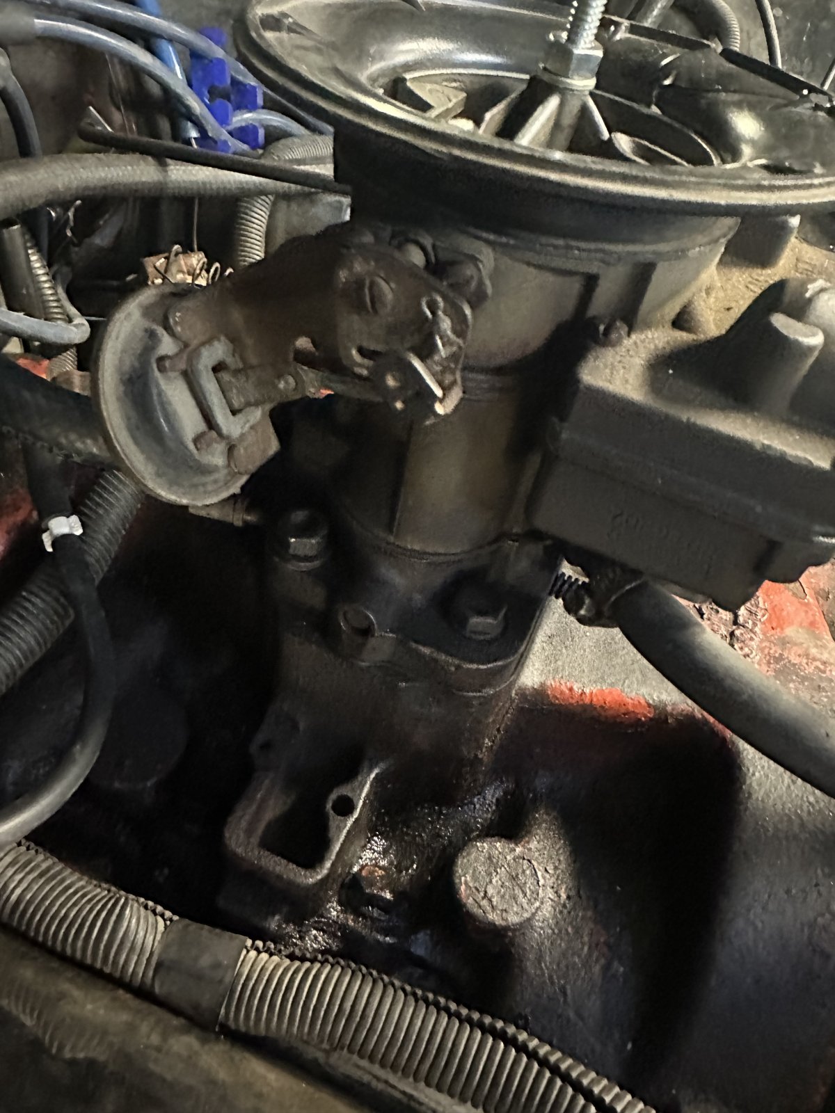

    I have a complete setup from a 72 C10 at the shop. I can pull it and stick it in the mail if you need it
    Kerrynzl and TA DAD like this.
  11. Lloyd's paint & glass
    Joined: Nov 16, 2019
    Posts: 10,856
    Kerrynzl and Johnny Gee like this.
  12. SDrocker
    Joined: Apr 9, 2014
    Posts: 591
    SDrocker
    Oh interesting!! When I looked up the block codes on the engine in my c10 I traced it to a 1975 C20 engine... the previous owner put a 350/TH350 in it.
  13. Lloyd's paint & glass
    Posts: 10,856
    If this will work for you it's yours. I don't have the heart to throw***** away lol, I always feel like somebody might need it :D
